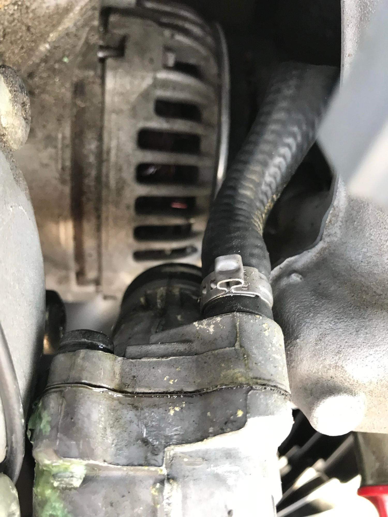

Default did this today
so to get to the thermostat you need to
1) pull covers from the electrical box on the far right area of the engine compartment, this will give you some room to access the serpentine belt and power steering pulley bolts
2) release pulley belt from power steering pump
3) remove bolts securing the power steering pump
4) restrain power steering pump out of the way
5) remove first top engine cover
6) drain about 3/4 gallon of coolant from radiator, then close off drain
7) undo clamp on outlet hose from thermostat
and here you are

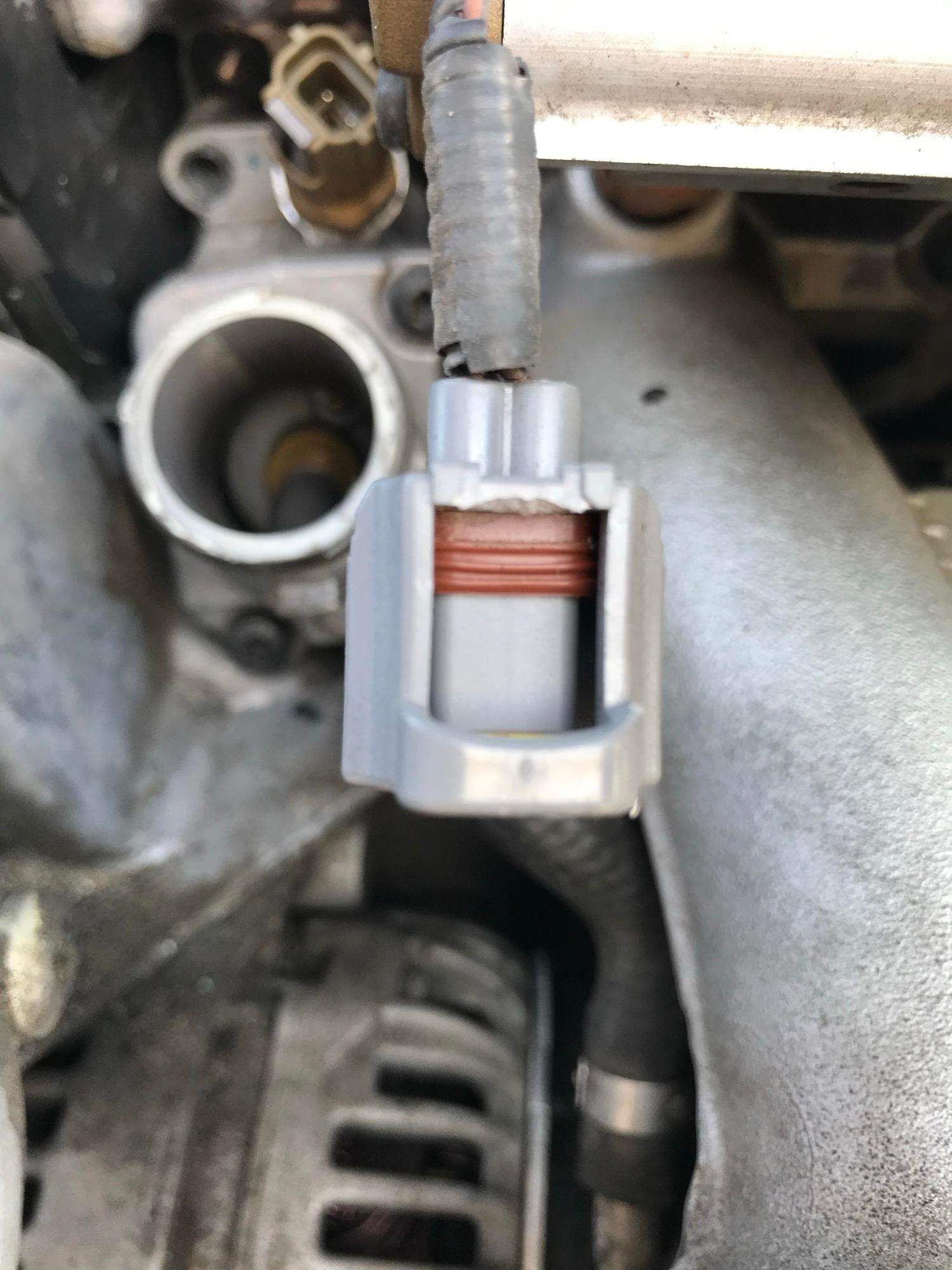

Old Sep 28, 2022 | 07:11 PM
stevepaa's Avatar
Joined: Jan 2009
Posts: 30
Default next
then get your t40 long extension to remove the two T40 bolts of the thermostat housing
and pull it
pull connector and hopefully yours is not as brittle as mine, it broke
if it does get a new one if you know how to disassemble them from TE connectivity
178449-4EJ-2 DBL LOCK PLUG 2P ASSY D
next is the oetiker clamp, you will need to carefuuly expand top loop for reuse unless you bought a new one before you started doing this job
then remove hose off thermostat housing by twist/pull
