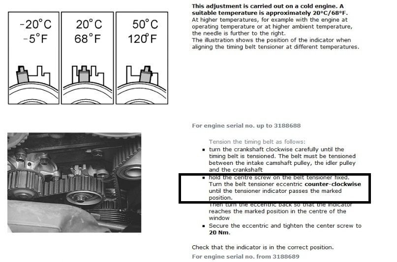

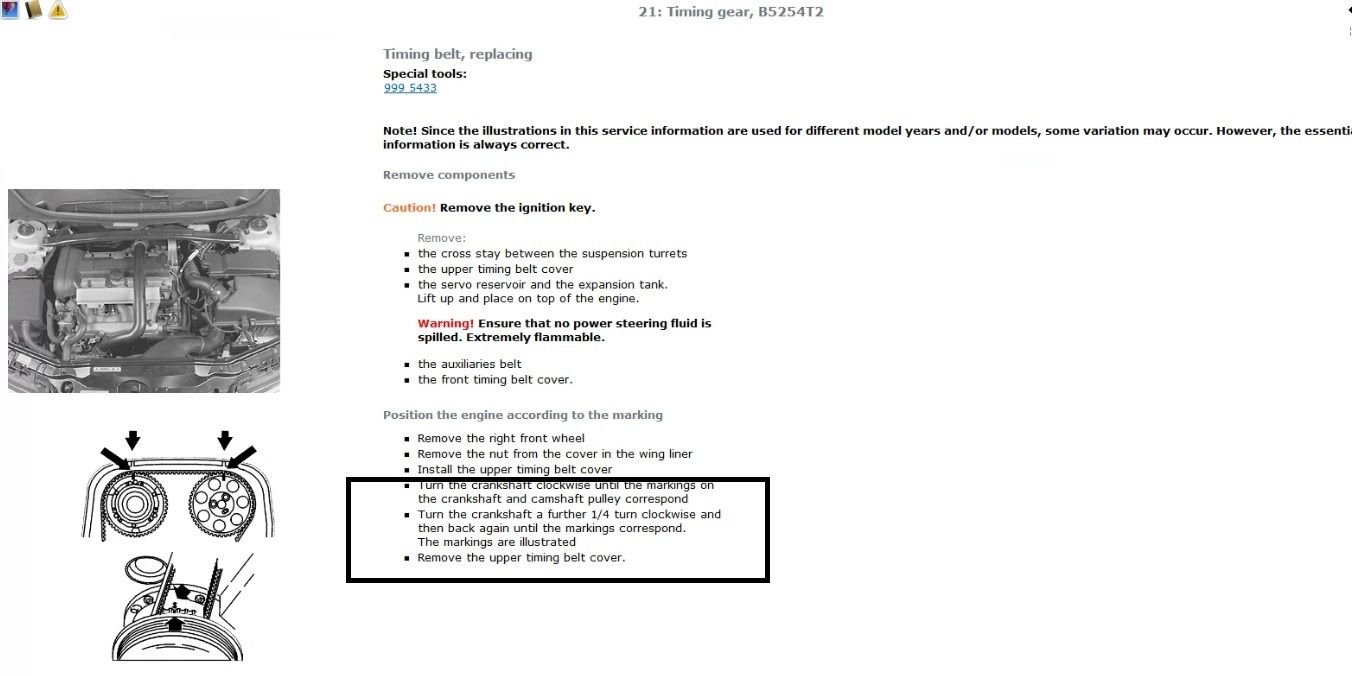

thanks a bunch, Hoonk.
I'm going to try to follow those instructions pretty closely as best as I can - I will definitely tell my buddy we need to follow it exactly as stated.
I almost conceded to paying 925 which I thought was kind of excessive considering the t-belt and tensioner are new already!!
