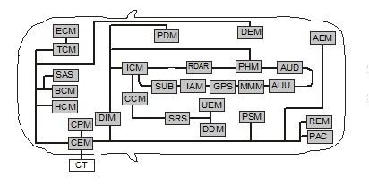

Originally Posted by DMS
code reader gives me NO CODES.
ROUTINE SERVICE NEEDED .
Your code reader (as others have mentioned) needs be able to read from ALL the modules shown in the network below (if equipped). Generic inexpensive OBD readers can only read codes from Emission related modules, usually just the ECM (engine) and the TCM (trans). Your service light/message means it has been ~7500 miles (on most cars in your year range) since the button was pushed to reset it. It's an oil change reminder light and your oil change provider should have reset the reminder when that was done. If they did not it is a simple process to reset.
