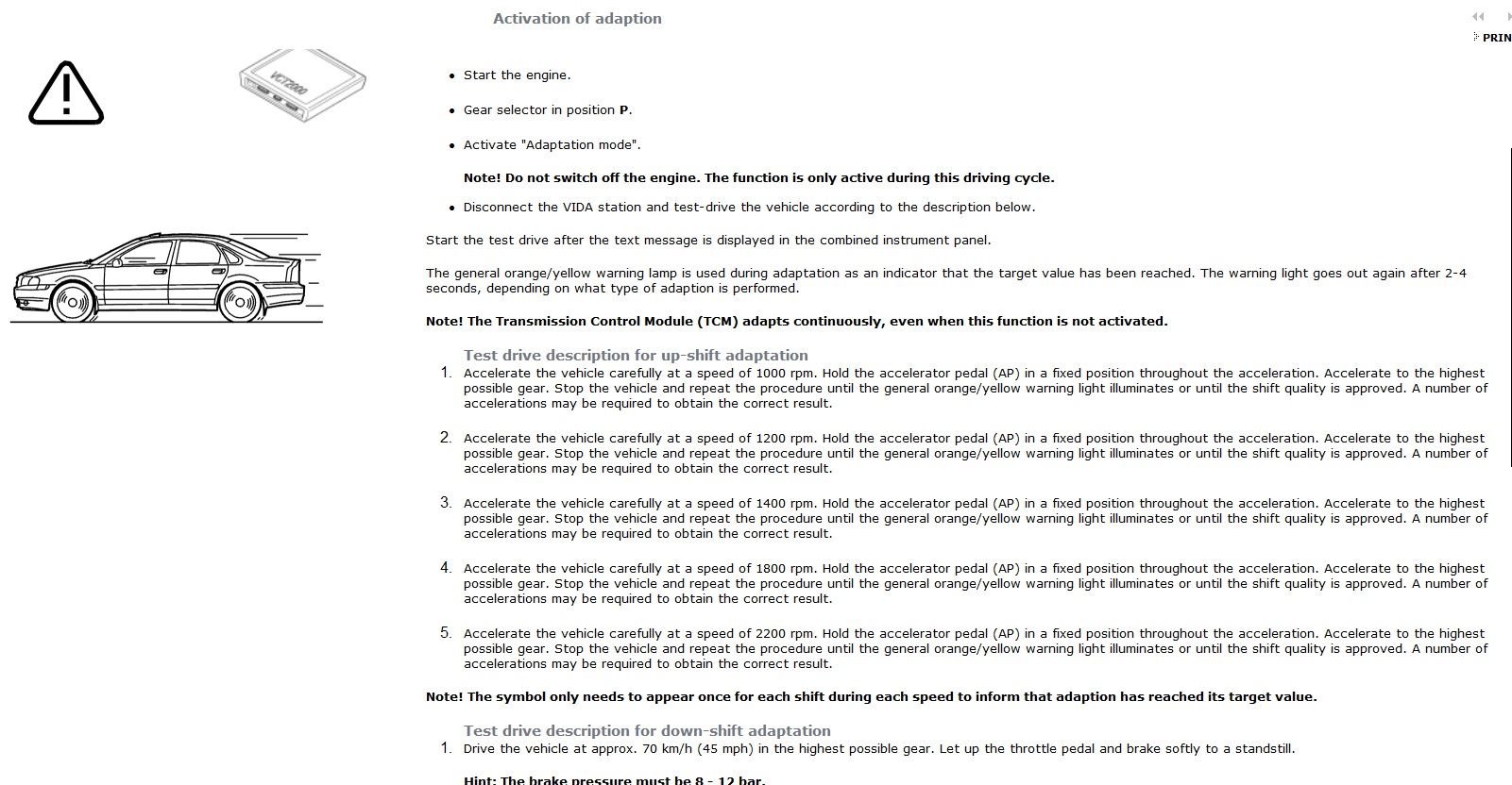

Sure - You could do the actual adaptation - here's a portion of it, you set the TCU into "adaptation mode", and drive the car - it's a page out of VIDA
Old Jan 30, 2022 | 08:59 PM
Here's the rest of the procedure -

I ran through the adaptation mode, set the final level of the fluid and it's doing great....shifts smooth, no flaring, no issues.
