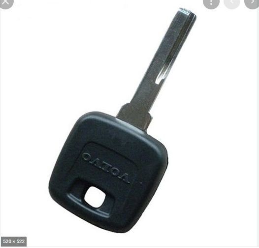

Ok - Let's start with the key. That car came with 2 switchblade style key/remote combos and a plain valet key. The switchblade key and remote purchased and "programmed" is about $450. The switch blade key is actually two parts and requires 2 downloads to make a switchblade key work - 1 for the key and 1 for the remote.
Why not purchase a plain chip key (as pictured below) precut from Volvo, and then have only the key "programmed"? I have heard that can happen for less than $200.
If your 2006 t5, t6, or v8 turns out to not need more than the car is worth to get it driving again (highly doubtful since the car is at an auction for $800)
And you really want to open the doors from afar with a button - You can purchase a seperate triangular remote and have it "programmed" for about $225 more.
