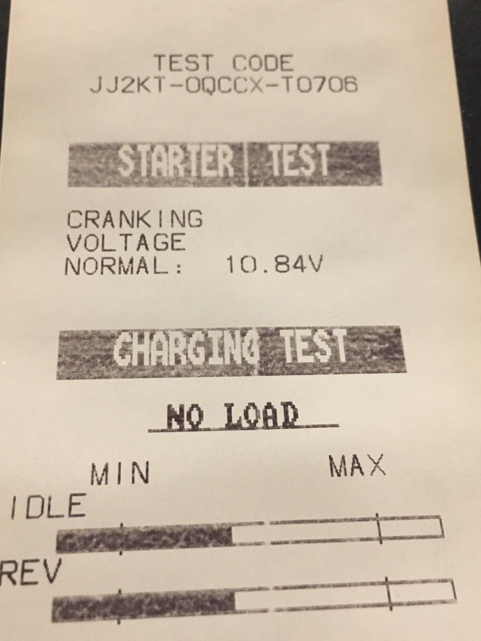

I was able to jump it, get it home and drive it back and fourth to work (40 miles) without issue. Just recently, the light started coming on frequently. I know it was time. I ordered a reman Pure Energy alternator from Rockauto.com
I broke my butt getting it in. Started the car and within 30 seconds the charge light came on and does it every time you start it. start up, charge at 13v and drops over the next 30 seconds.This is a different symptom than the original. I am guessing the alternator is bad out of the box or may have the wrong regulator in it.
Not sure what to do next??? Either order a new voltage regulator and install it in the old alternator or buy a reman Bosch alternator at $250. My only concern with buying a Bosch reman is that in their description, they advertise the regulator is only replaced if needed?? I don't feel good about this at all!!! This job is way too much of a pain in the *** to do over and over as this will be round 2!. Don't understand why Bosch just doesn't just go ahead and install new regulators in their remans? Obviously the alternator they are re manufacturing failed. The regulator is the #1 cause failure in an alternator.
So my questions are do I replace the alternator with Bosch reman, aftermarket new or just replace the voltage regulator? I'm not trying to cheap out, I just dont want to do the job a 3rd time. My other question is does anyone here suspect a problem other than the alternator? Maybe the ECM? Would love to hear what anyone has to say.

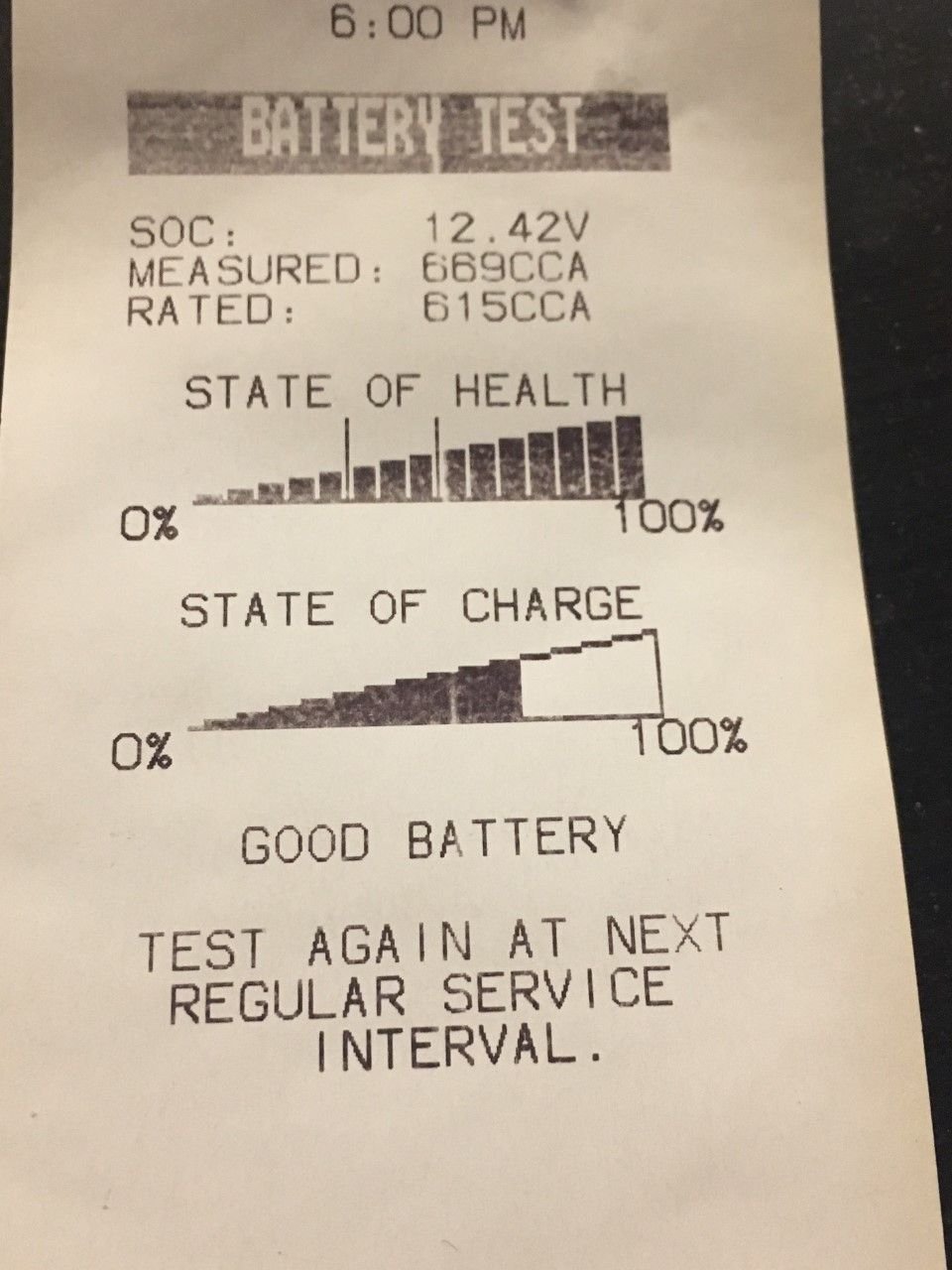

By the way the battery is roughly 8 months old and has tested fully charged and in 100% health.
