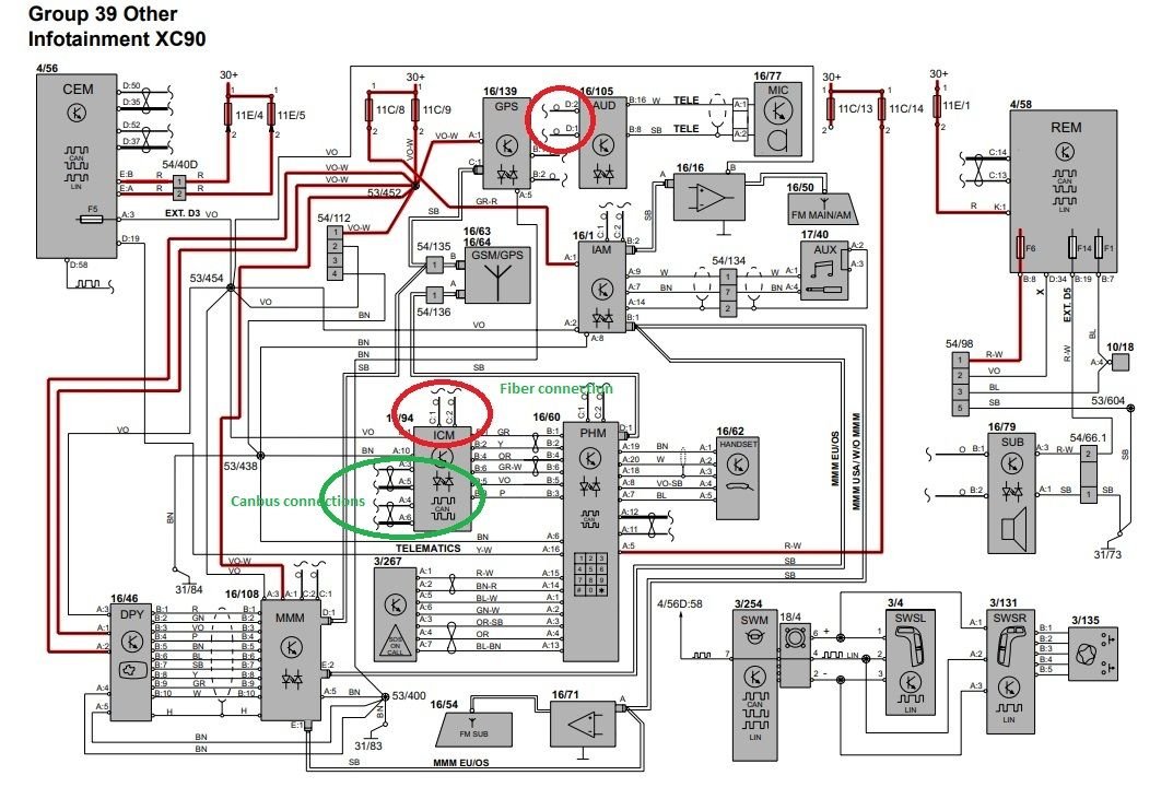

Aftermarket head units in an xc90 are not as simple as you would hope. Have seen a few and most of them sounded pretty good.

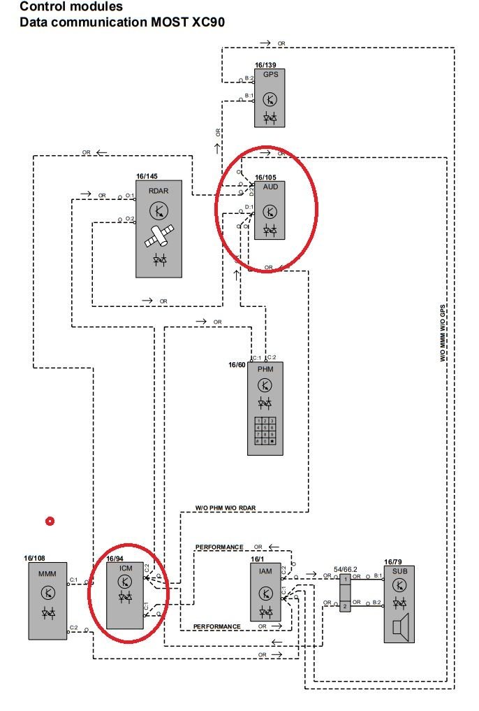

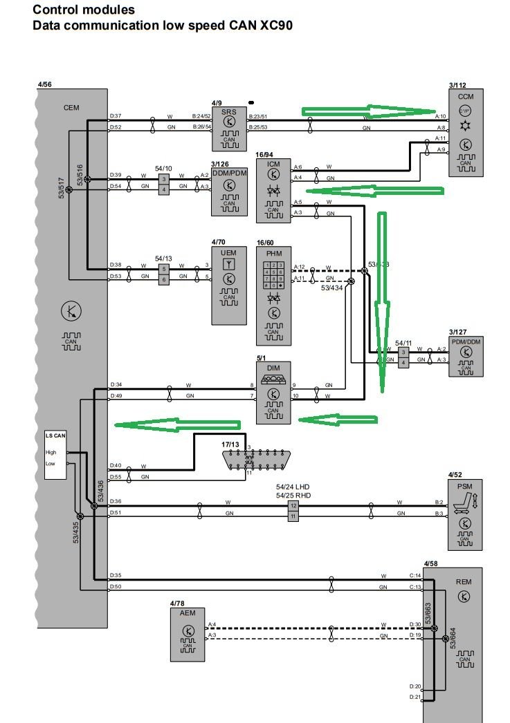

The xc90 sound system uses a fiber optic bus. If you plan to use any existing components - like the amplifier - that bus must stay plugged in. In aftermarket systems I've seen installed in xc90's the ICM (infotainment control module) - that's the control panel on the dash - is placed under the passenger seat so it can still be connected on the fiber optic bus and low speed canbus. The speakers are powered by the AUD - audio module that's on the fiber optic bus also. The ICM is also on the lowspeed can bus. Those bus wires must stay plugged in or the climate module, SRS (airbag) module and the DIM (instrument cluster) won't work. Below is a diagram of that fiber optic bus - listing all components that could be installed. You may or may not have the phm, phone module, sub for a subwoofer, rdar, gps, mmm modules in your car. Also shown is the wiring diagram and low speed can bus. .
