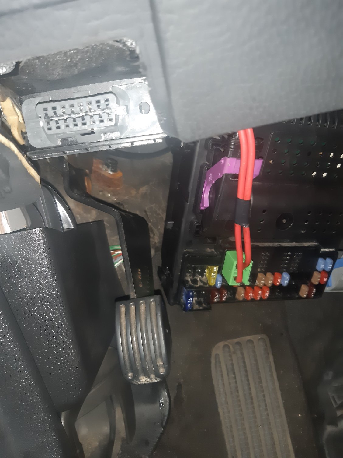

I pulled out the CEM and took a photo of where I see the water coming from (its behind the metal bracket that holds the module in place )
The water drips on that bolt behind and down the side.

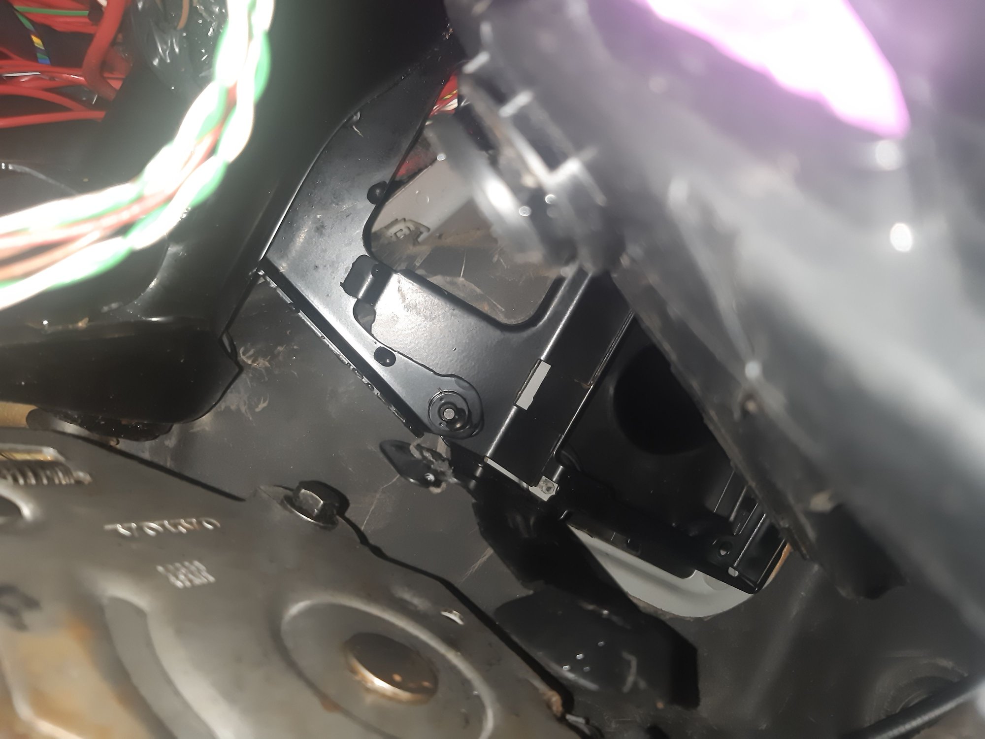

The camera is facing up here. The water drops here and keeps dropping long after the rain/washing is over meaning its collecting somewhere
