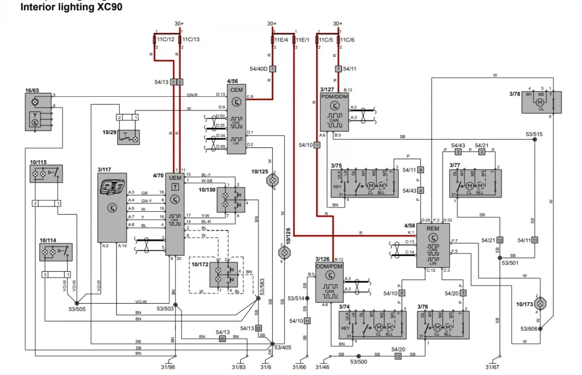

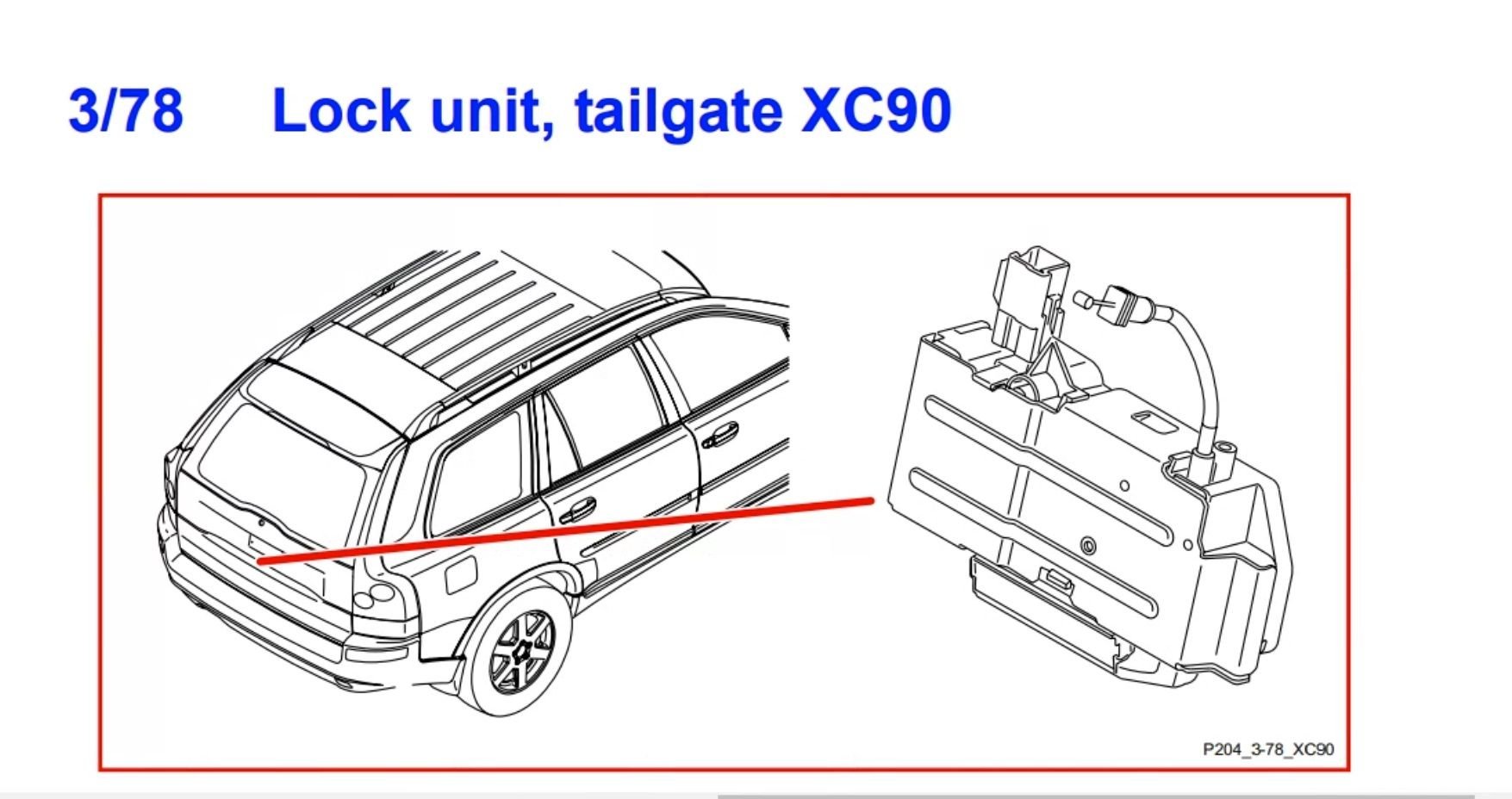

On the diagram 3/78 is the tailgate latch with the switch in it - the light is 10/173.
