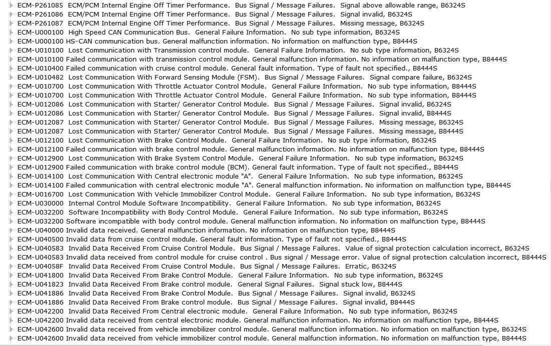

In Volvo codes - there's no "U011400 - Lost communication with differential electronic module" listed in the ECM. What module was that found in? (list of available ECM U0 codes available for a 2008 xc90 awd below)
In the DEM this communication code below is possible - most commonly caused by a bad DEM that was possibly fried due to a bad haldex pump or corrosion.
