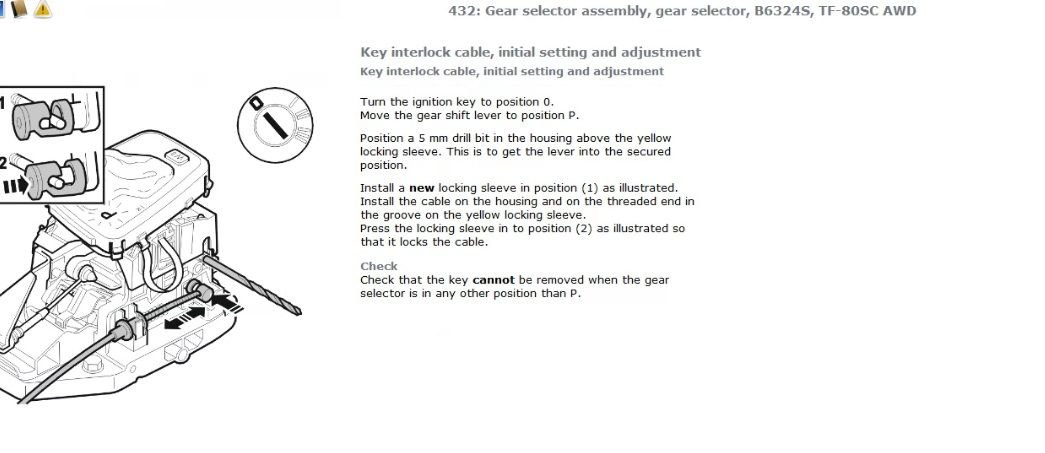

Old Feb 26, 2022 | 02:57 PM
Here's info to adjust the cable to the keylock - Vida does not have info about adjusting the shift cable (at least in the copy i'm looking at)

Update: I took the car to a specialist shop. The shifter cable (from gearshift **** to gearbox) was loose at the gearbox side in the engine bay. They removed the airbox to get to it, job done. No spare parts needed.
I didn’t get to see exactly what part was loose, and I also don’t know if the loose cable led to the broken “claw” or Vice versa, but I hope this will help someone else in the future.
