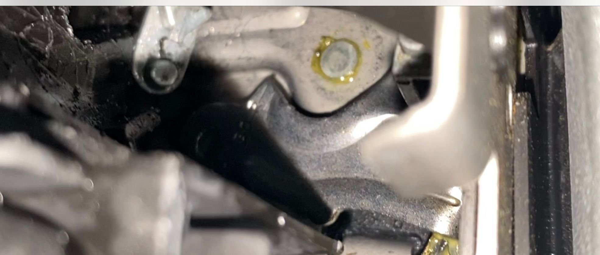

Hi there, same issue on a 2015 XC90. Rear door not opening, I'm going to attempt a fix tomorrow with the following information below.
removing the door card - Yes this door is open but give you an idea of whats going on :
I am hoping this is a similar lock to the XC90, it cant be that difference so going to give this a go tomorrow.
Also second hand Mk2 XC90 door locks are on ebay for about £80

Default I got the door open
Door is open, took about 30 mins, its a bit of a fiddle.
OK! update, after a cuppa tea I shut the door and tried to see if it would work and the door is opening fine from the outside handle. shut and opened it about ten times. Also opening from the inside handle.
This appears to be more a latching problem with the door mechanism. As above and discussed when the handle is pulled at the wrong time as the car is being unlocked it must jump out of place.
the lock is fine, going to check all the possibles with locking and unlocking and will put back together.
This afternoon will be a small talk to the children about touching the door handle before Daddy says you can😂
Have a go if you are really stuck and your cars is over 5 years old, or not willing to pay for the repair.

I have the same issue (Rear Right) on a 2017 XC90 T6 R-Design.
Thanks to above posts, I got the door panel off and broke-off the top corner of the plastic covering (similar to above photo) to get to the latch mechanism.
I’m just stuck and can’t figure out how to get the electronic latch to release. I’ve tried everything but no luck
Has anyone figured out or has a photo/video they can post to highlight this last step?
once I figure it out, I’ll post the DIY steps with video/photos and link it here for everyone else’s benefit.
Thank you!!
This just happened to my 2016 xc90 I found that this latch was very stiff and when I pushed it back it then allowed it to open. I then sprayed a load of white grease on it and it’s seems to be fine now.
