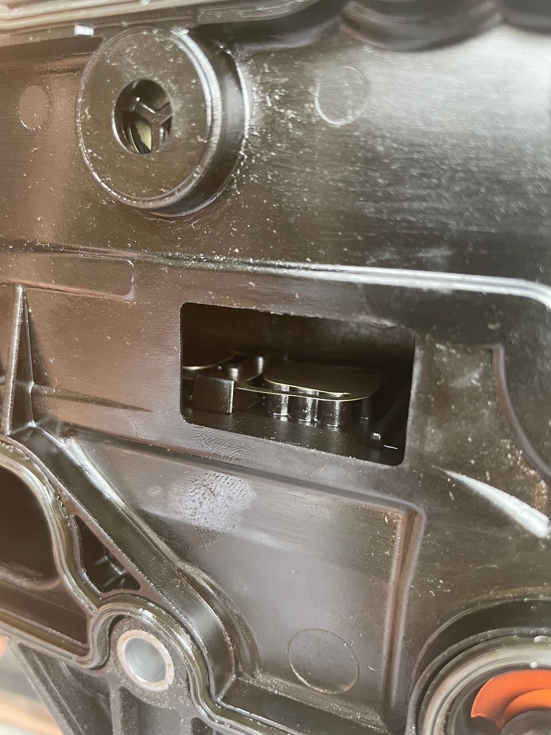

1st I got suddenly high oil consumption about 1L per 1500km on my 2016 XC90 at 125000km
few weeks ago I got engine code P0171 which is LEAN GAS ON CYLINDER 1 . i suspect bad Cylinders or cylinder rings. i also found out unusuall state of PCV box after removing it.
check pictures. I fixed the issue and waiting to see if it helped.

after I unscrewed the OIL TRAP / PCV box i found that both metal plates / valves were detached from their original locations and were lying on the bottom of the PCV box. I am not sure if they were not installed properly at the factory or they were blown with high air pressure because other component failure.
I put them back and locked them in place. After tthat my ERROR P0171 went away after that BUT week later came back I got CHECK ENGINE LIGHT AGIAN . I have to see if it happned agian or something else happened and I will report back in a 14 days since I am away now. I am also planning to check compression at each CYLINDER and see if I have in fact PISTON RING problem.

I'd suggest two thing 1) replace the PCV oil separator with a new unit. If something "falls out of place" - well that's not supposed to happen and the part is failing and will eventually again 2) you may have something else going on that caused the part to fail. Before replacing the part, I'd have a shop do a crankcase pressure test (or do a rubber glove test to see if there's excessive pressure or vacuum). It can't hurt to do a compression test but I doubt if that's related, particularly if you don't have other symptoms like oil consumption, hard starting, fouling plugs, smoke on deceleration etc.

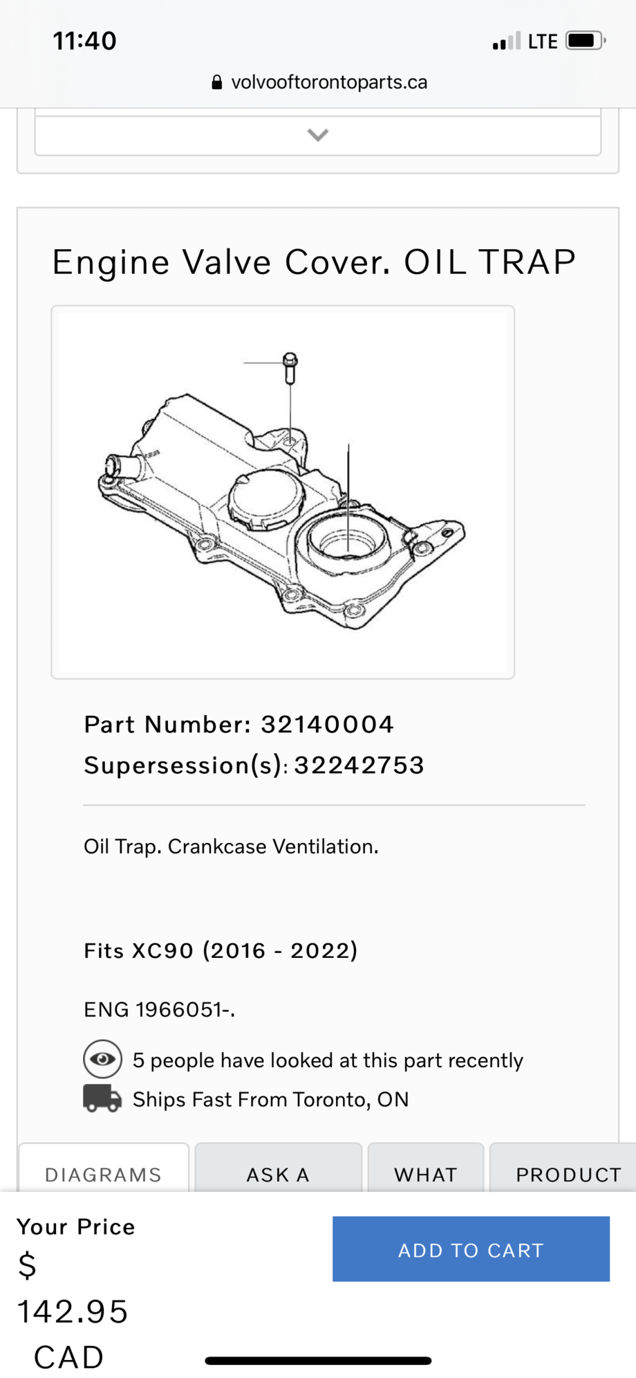

Get a new oil trap for $40 on Amazon and see where that goes.
I had the P0107 code for months and the stealership wanted $500 just to diagnose it (gave me the old spiel of "well it could be anything, so we have to check everything" nonsense). Well when the car started squealing at idle, I was told by someone on Swedespeed to try replacing the oil trap. I did and VIOLA! - no squeak and the CEL is gone (had to disconnect the battery for a few mins).
