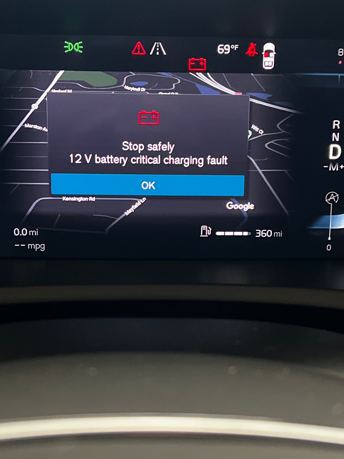

Hi!
First time Volvo owner here. Bought the 2023 XC90 B5 Mild Hybrid. On three occasions, I have gone to my car to find the batter is completely dead. I live in NYC and may go for days or a week without driving the car.
Each time after getting jumped off by the parking garage or by Volvo roadside assistance. The first time, after getting jumped off we started on our trip and while on the FDR, the car began delivering error messages (stop safely - 12v battery critical charging fault and SOS e call service required)and went into a reduced power mode (which was quite frightening). Each time I have had to take the car into the shop.
Volvo of Manhattan has performed a parasitic draw test and found nothing although the car died again during the week it was in the shop. They have said the battery looks good.
On the car’s second failure, they advised me that the battery was dying because the car was not being driven enough. I asked them how often the car needs to be driven and they said at least 15-30 minutes 5-7 days each week. (I know better than this). They said the car needs to be connected to a trickle charger if it is going to go for more than a day or two without being driven.
On the car’s third and most recent failure, it has been in the shop now for over a week. Volvo of Manhattan has reiterated the requirement that the car be driven daily. They explained that a lot of Volvos in Manhattan with Google are having similar issues since they are not always driven every day; this sounds to me like they are admitting a defect.
Has anyone had a similar experience with a frequently dying battery?
Has anyone had experience dealing with Volvo in a buyback or exchange of a lemon (NY law says if the dealer cannot fix the problem in four attempts or the car is the the shop for more than 30 days… I’m already on day 25)?
Appreciate any advice!
Michael
Stop Safely 12V Battery Critical Charging Fault
