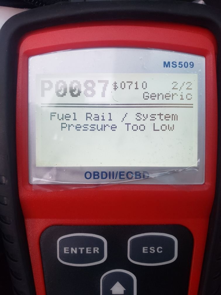

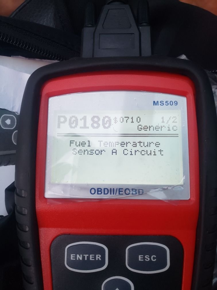

I have a 2008 Volvo XC90 3.2 cyl, and I currently have the codes, P0087 and P0180.

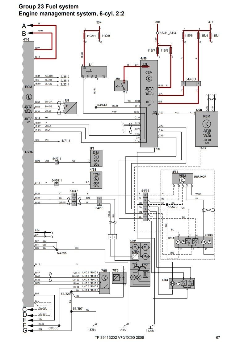

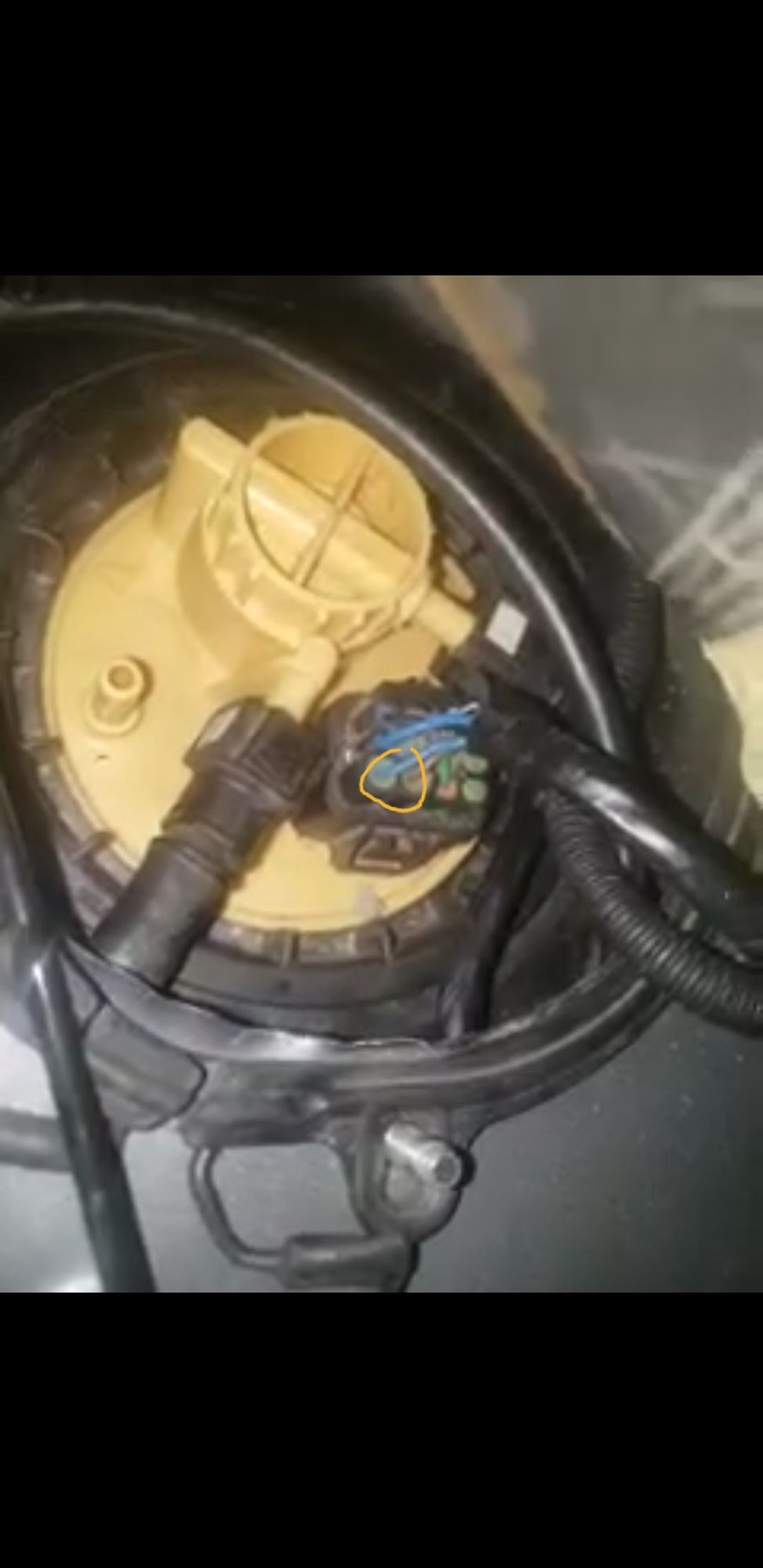

I checked the wiring and noticed the skinny blue wire from the CEM and/or REM does not have any electricity, which I believe controls the high pressure pump. How do I get electricity to these wires?

in terms of the blue wire, I just know it's the skinny one, and it comes from the CEM.
(From your response, it seems like I need to go more in depth on my data.)
The blue wire in bottom left corner of the harness.

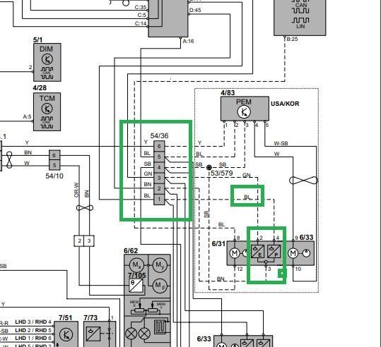

There's 2 blue wires - one goes to the pump motor and looks like the other might go to the fuel level sender.

It is the blue wire that goes to the pump motor, particularly the high pressure motor inside the pump because I believe there is also a secondary pump too.

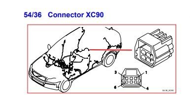

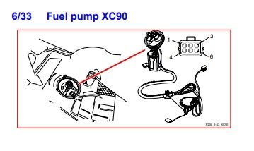

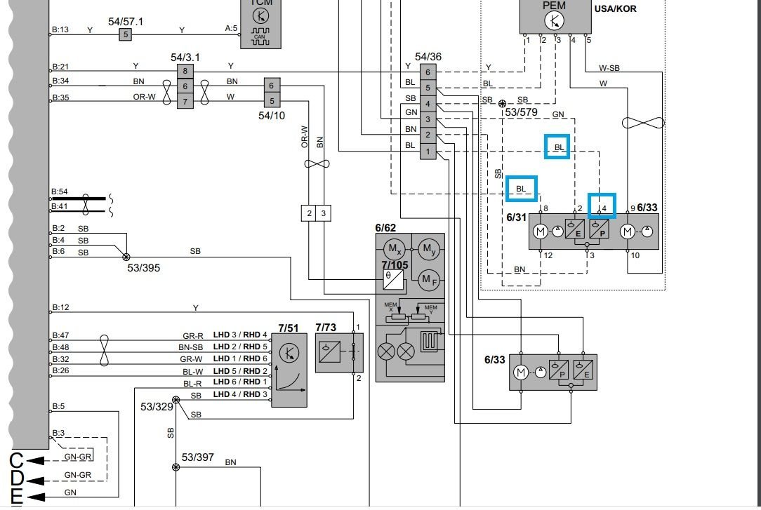

Here's the pin numbers on the pump - with a small and a larger blue wire - I would bet the larger blue wire is for the pump, to carry more current (than a signal for the gauge)

So number 1 is the smaller blue wire that is not getting electricity in my car.
Number 4 is the larger blue wire that is getting electricity.
Overall, what route should I take to get electricity back into the blue wire?.
Old Sep 12, 2024 | 09:31 PM
Originally Posted by RoyalLewis
Overall, what route should I take to get electricity back into the (small #1 )blue wire?.
54/36 is the 6 pin connector that plugs into the fuel pump. The small blue wire (at terminal #1) goes to one of the sending units (not the pump portion). Why would you want to inject power into that wire and risk melting your gauge or sending unit?

(Your terminal diagrams switched the numbers)
Old Sep 13, 2024 | 10:05 AM
Well,
With the low fuel pressure, I'm trying to figure out what's the next move.....

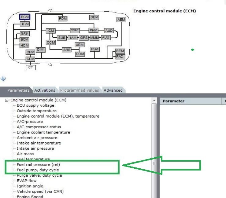

Those are wiring diagrams from Volvo - you can find them at Volvodiag.com under the EWD tab.

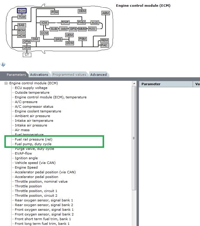

What's the fuel pump duty cycle?​​​​​
What's your fuel pressure measured with an external gauge?

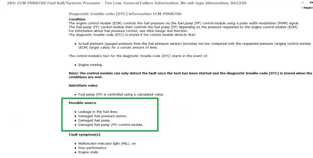

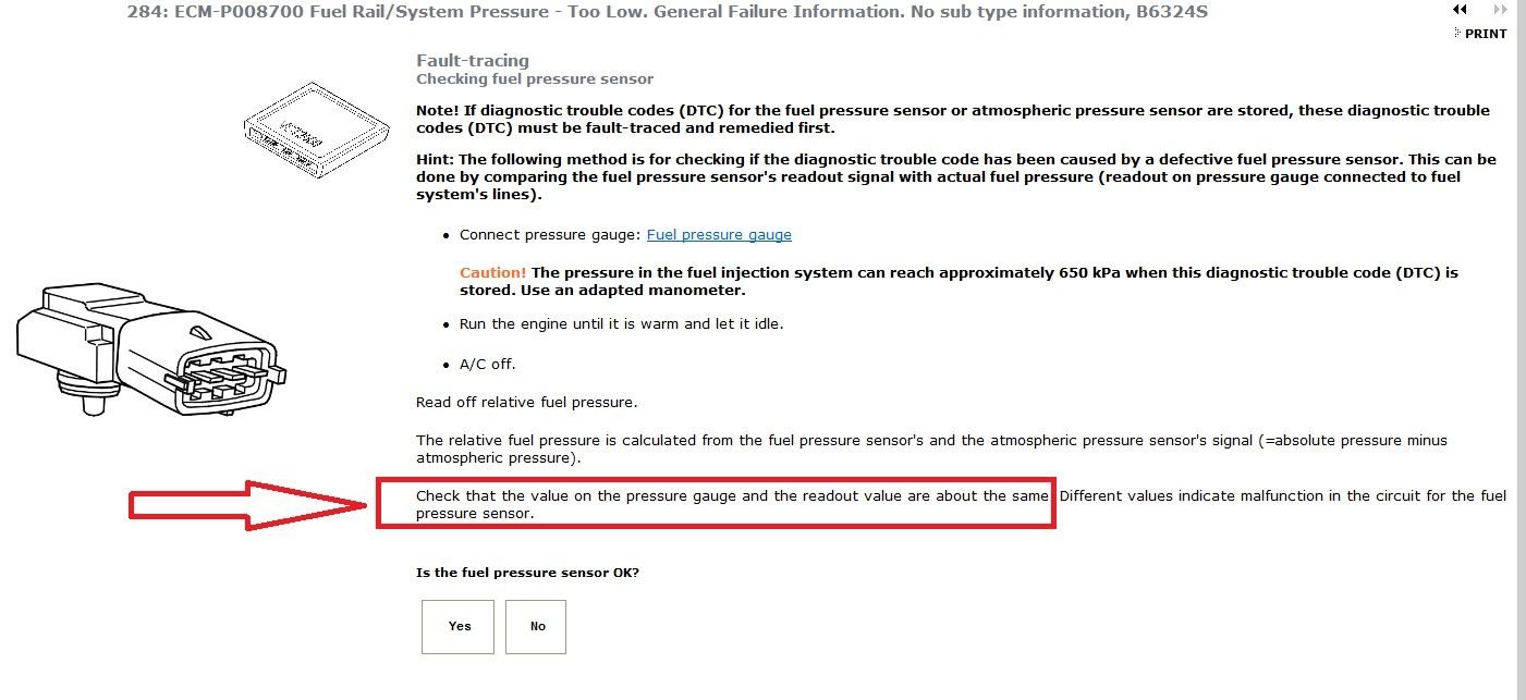

The fault tracing that Volvo suggests for your code is - Measure the fuel pressure and compare it to what the pressure sensor is reporting.

Old Sep 13, 2024 | 05:19 PM

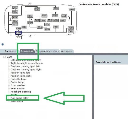

What happens when you activate the fuel pump relay with your scan tool? Whats the pressure reading from the Fuel pressure sensor then? With 0 fuel pressure the engine will not run. Previously you stated the engine does run (for a while)

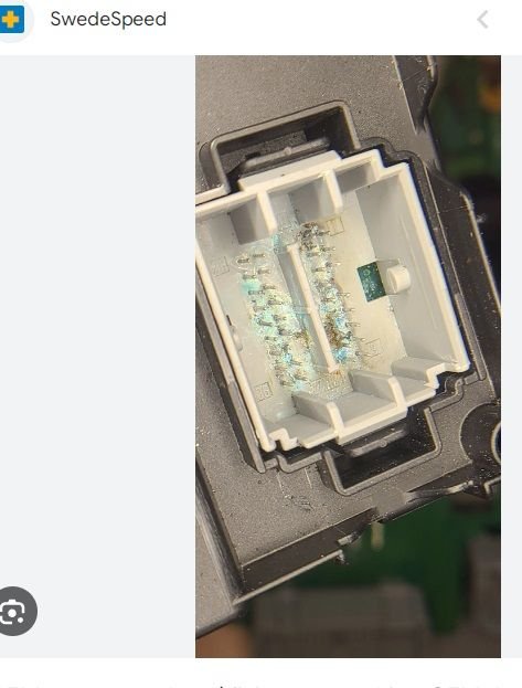

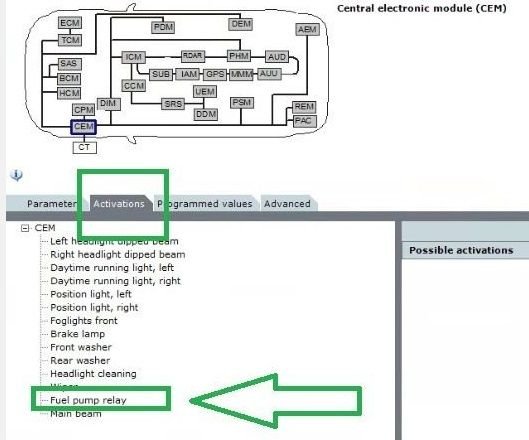

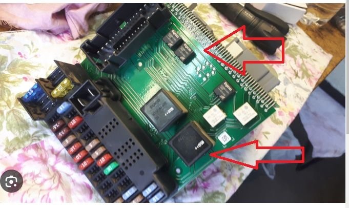

That is true - there is no external/replaceable relay. There may be one soldered in the engine control module or the CEM. Volvo's diagnostic software does have a way to activate the "fuel pump relay" manually. I trust that is to be able to check the fuel pump operation without the car running.
On the lower picture I'd imagine at least some of those 7 cubes soldered onto the CEM are relays.
Speaking of the CEM - water intrusion (into the CEM) is a problem on some Volvos - have you checked for that problem with your car? Anything else weird happening other than it has no fuel pressure even after replacing a bunch of parts?
