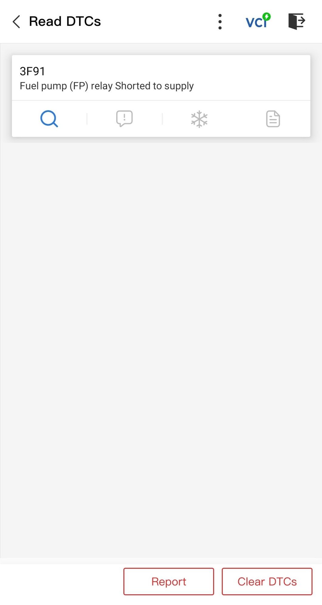

Welp, I took out the Delphi fuel pump, and replaced it with a used Volvo OEM fuel pump. The car crunk right up, and ran for 25 mins before it shut off . I'm not sure what's going on. I do find it weird that the ECM relay fuse gets hot.

Shorted Circuit in the CEM to the fuel pump relay.
