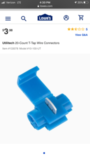

I got my old one out new one installed which took all of 8 hours. 1 day later My POWER SYSTEM FAILURE SERVICE URGENT came on the dash. I found that my LIN wire connector on the Alternator was loose and would only slide up and down and would NEVER clip into place onto the Alternator. I bought a replacement Alternator plug off eBay for $8 and used cut off the OLD Connector. I used a Tap Splice connector and plugged the new harness / connector on to the Alternator but it was stil not charging. I thought F**K I may have to drop the Alternator again and have it tested. I also NOTICED my Washer T connector on the Pass side was also broken on the bottom which dumped Fluid down towards the alternator, so i replaced that as well.
Here is what I'm getting at....I NEVER saw this on ANY FORUM, so I wanted to SHARE in case someone runs into this as well. I have a iCarsoft Scanner. I thought WHY NOT checked and see what codes it may display. I showed the ECM having a ECM-U012087 " Lost communication with starter / Generator Control Module.
ALL I DID WAS ERASE THAT CODE AND BOOOOMMMM THE CAR WAS BACK TO CHARGING!!!!!! It has been 2 weeks since I have cleared that code with no issues charging. CHECK YOUR VOLVO ERROR CODES WITH A SCANNER, AND ERASE! I hope that helps someone!
