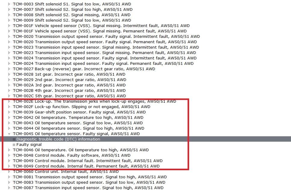

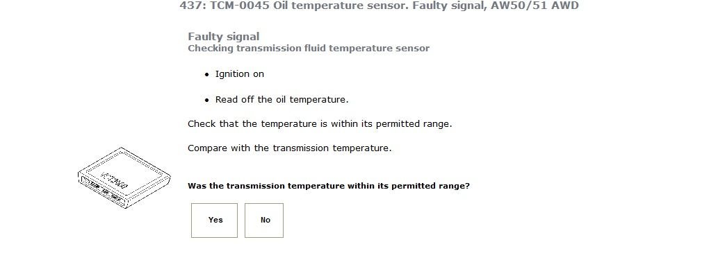

What Volvo code is that generic code equivilent to? If it's TCM0042 - here's what Volvo suggests might be the problem and how to test it.
