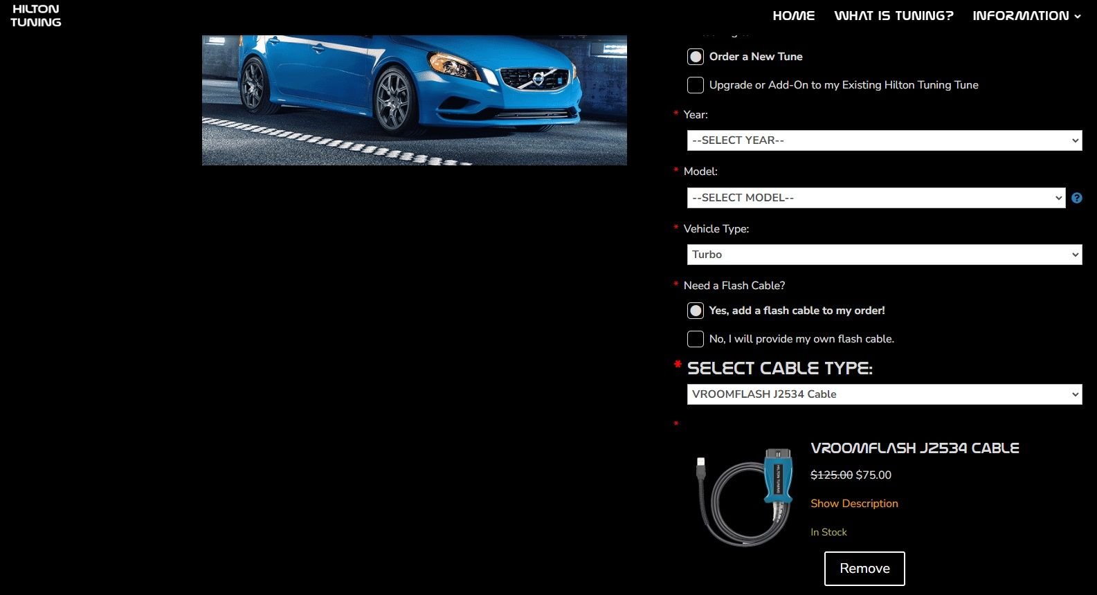

You will need A dice unit or possibly a J2534 cable such as shown below to interface between your OBD port and your CPU. (I have no experience with J2534 cables, but allegedly they work)
