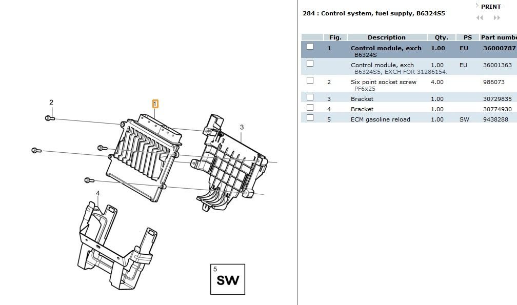

Most major control units in a Volvo are "coded" to the VIN. Meaning used control units are not plug and play, and WILL NOT WORK in a different car. The Volvo software VIDA (with a VIDA subscription) is used to "program" a NEW control unit to work with a car.. VIDA can't make USED control units work in a different car. A company such as xemodex can "reprogram" some used control units to work in a different car.
I'm certain a NEW control unit is available - however if you google 36000787 you will find a list price of about $1869.00. (plus labor and programming) Not something you would want to guess at replacing.
Compression? Fuel pressure? spark at the right time?
Rather than randomly replacing more parts (and getting more frustrated by spending $$$ on stuff you don't need ) You might want to seek professional help.
