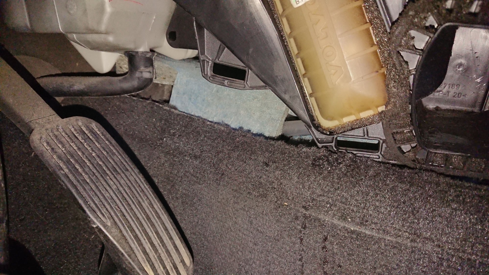

The same problem with V70 II. The hose is not visible from under the car due to plastic covers but it quite easily accessible from drivers side(left) after removing plastic covers near accelerator.
