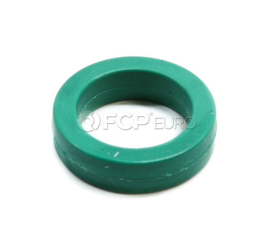

You mean this seal? this goes on the dipstick tube, on the bottom to seal between the tube and the block

My o-ring is black, not green.
Is there a part number for what you picture if the seal I got is not the correct one?
