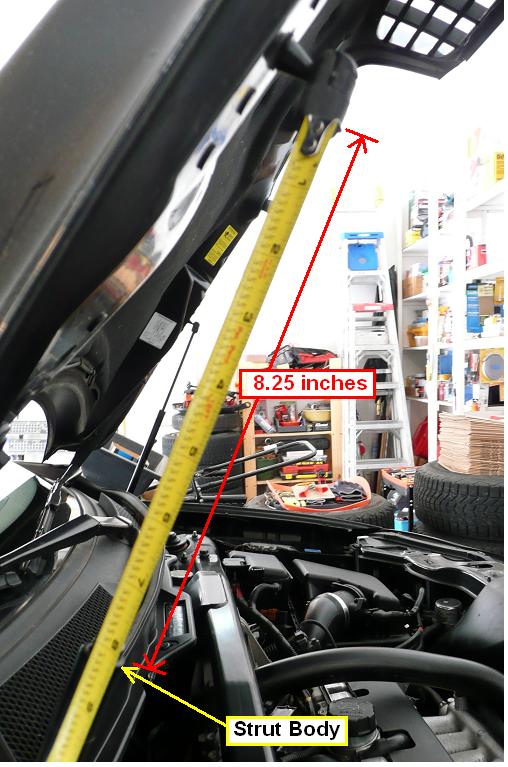

1. The distance for the rod part is 8-1/4 inches.

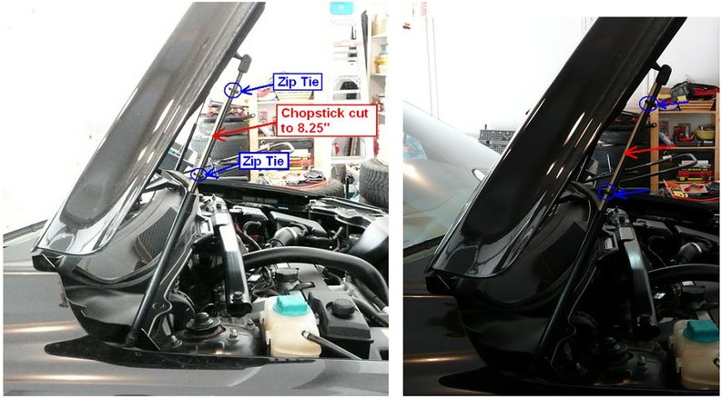

2. Cut the chopstick a tiny longer than 8-1/4 inches so it is a tight fit.

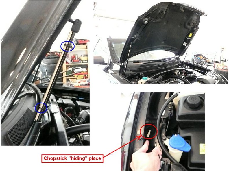

3. Place it with zip ties. Don't tighten the zip ties too much, just snug it.
4. When done, simply "hide" the chopstick as shown.
