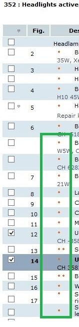

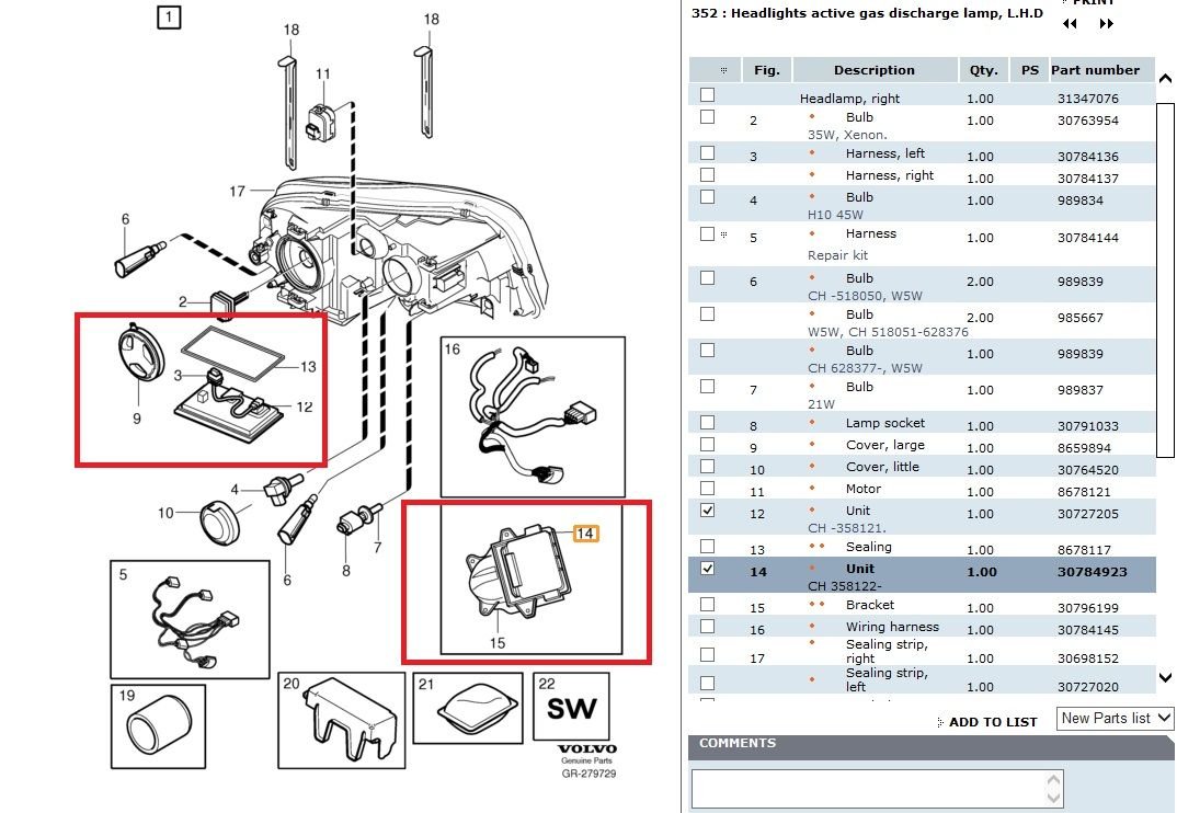

It's either #12 or #14 depending on the VIN of the car.

I know it's not #12, I checked that last night. I did see somewhere where it was located in the wheel well. Could that be where #14 is located?

Won't be in the wheel well. They are usually mounted on the headlamp assemblies. On the parts page - the red dot next to those part numbers indicates that part comes with a complete new headlamp assembly. In other words it is bolted to the headlamp. What's the last 6 of your VIN? (to determine if it's #12 or #14)
Are you sure you have HID bulbs? Is an H11 mounted in the low beam position? If so you don't have HIDs and don't have ballasts.
