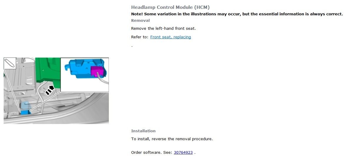

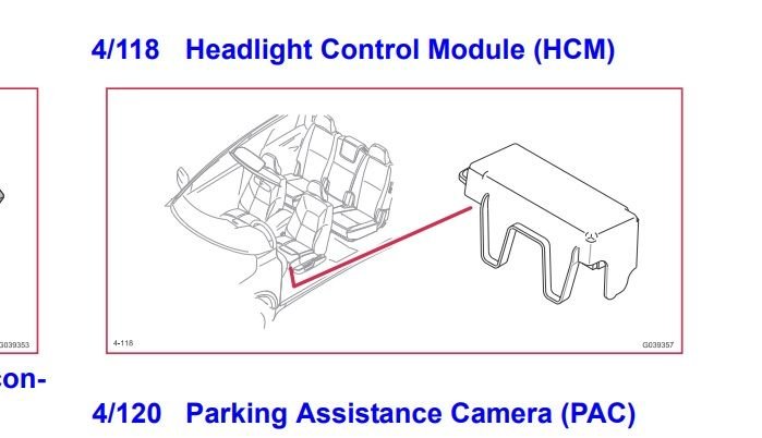

I found an actual picture of this
and a price tag here:
https://usparts.volvocars.com/p/Volv.../30782605.html
