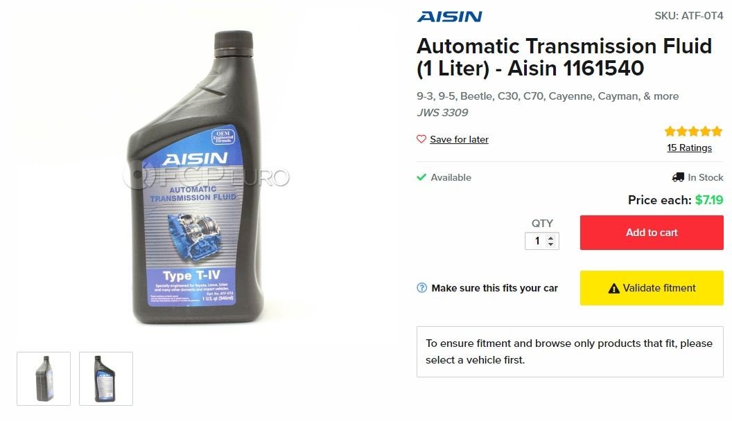

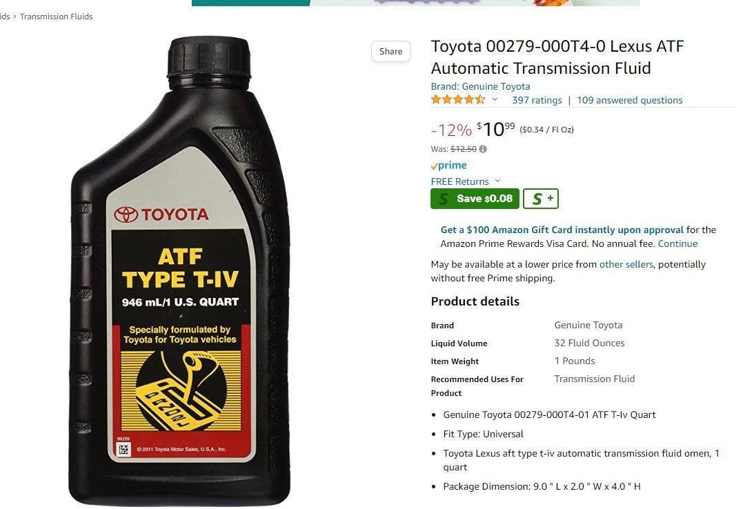

Your trans should take the 1161540 fluid (up to chassis # 568000) Used in the 2001 - 2014? transmissions. Expensive from Volvo but the same exact stuff is sold under many brands. That transmission (or similiar ) is used in many brands of cars. The Toyota T-IV fluid can be had reasonably priced sometimes. DO NOT put the wrong fluid (or any additives) in the transmission.
