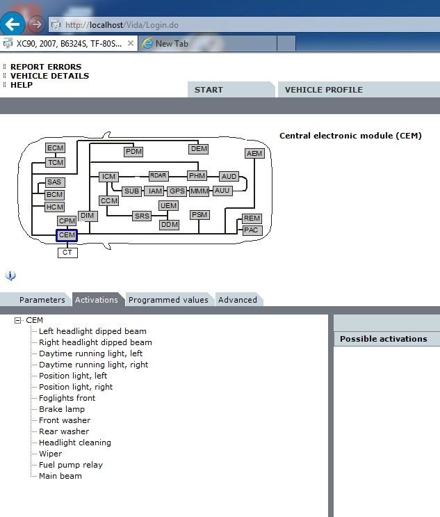

The number plate lights are 10/3 in the diagram. That might mean the Light switch module 3/111 is telling the CEM to turn on parking and tag lights. With Vida or a good scan tool you can activate most lights -
