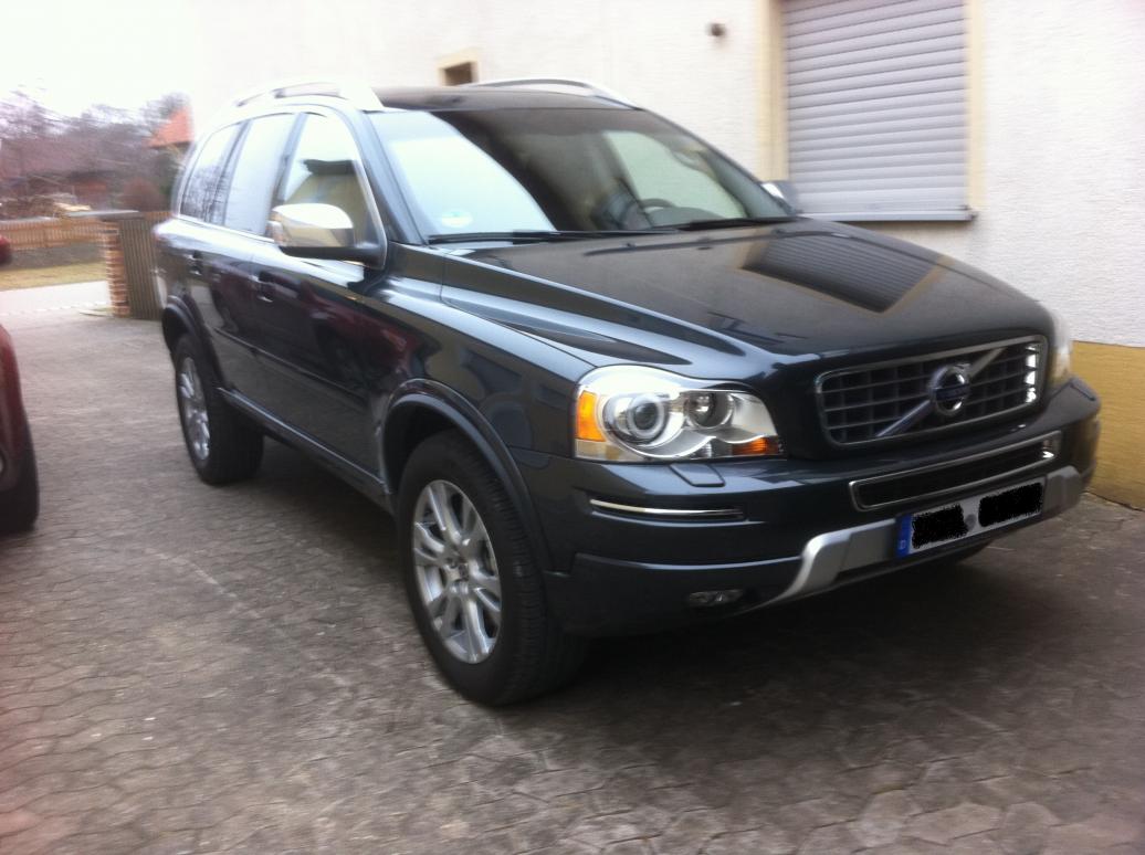

Has anyone added AUX foglights yet?
The only thing I am disappointed in is the fact the DRLs are located where the foglights go, and unless I am missing something they do not turn on with the headlights as a independent light for near side visibility.
This is GREATLY needed where I am at in Germany... so I may be cutting into the vehicle even though it has less than 1000 miles on it just to make up for it

No, fog lights that turn on seperately.
Most european cars have full headlight control. The XC90 has the rear fog light (required in most european contries) but not seperate fog light control, or any at all.
The DRLs are located where the fog lights go in the 2013. I dont know if every year its that way. The way the DRLs work is the headlight switch has to be turned on with the auto switch engaged. The light sensor tells either the headlights or the DRLs to be on, but the DRLs dont seem to work without it set up this way.
I sort of like this set up because i can turn the lights off so it doesnt blind the gate guards, but it would be nice to have fog lights also.
