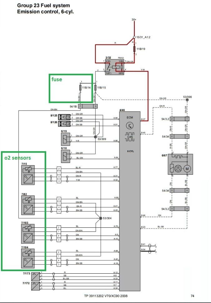

O2 sensors are not grounded through the exhaust. Don't know what engine you have but the 5, 6, and 8 cylinder O2 sensor heaters are powered from fuse 14 in the b fusebox.

Thanks. So you're just noting they're all grounded through fuse 14, not that fuse 14 is blown, correct? (That would throw a different code.)

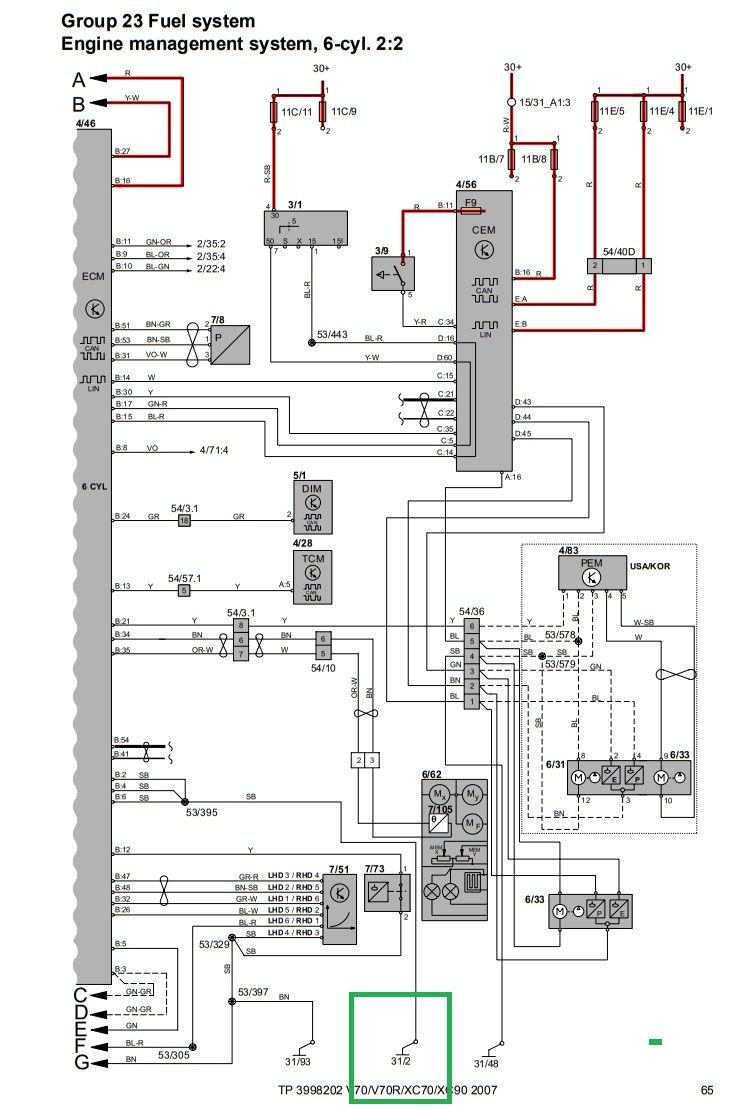

Looks like O2 sensor heaters are powered from fuse 14. Should have 12v at the gn/bn wires going to each O2 sensor with the engine running. No ground connections are shown in previous diagram - Only ground wires I see on the ecm is at point 31/2
