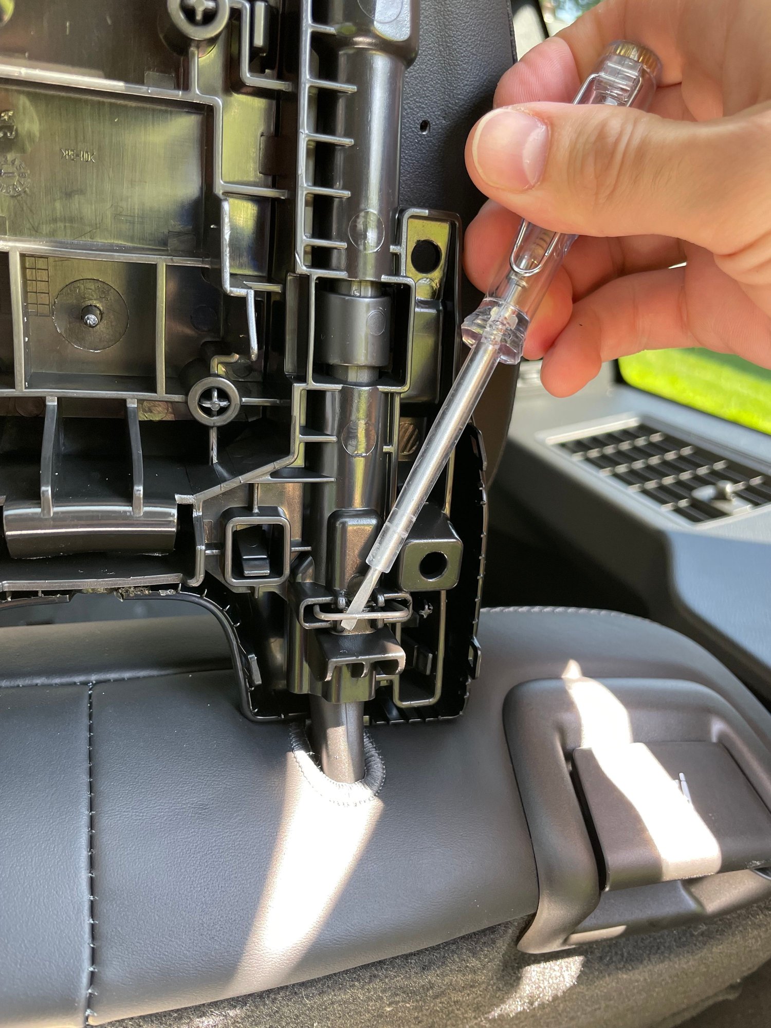

Just wanted to share (10 years later) how I removed the headrest on 3rd row of my Volvo XC90 2021.
1. Remove the plastic cover. It takes some effort and using a flathead screwdriver to pry it open, but it's doable.
Before
After
2. There's a thin metal clamp that can be easily removed using a screwdriver. There are 2 of them per headrest, remove both of them.
3. Pull out the headrest, it should be very easy to take it out now. I don't think the metal base can be removed, but at least it's easier now to install car seats on the 3rd row and my back view is less obstructed.
Hope this helps anyone.
Before
After
