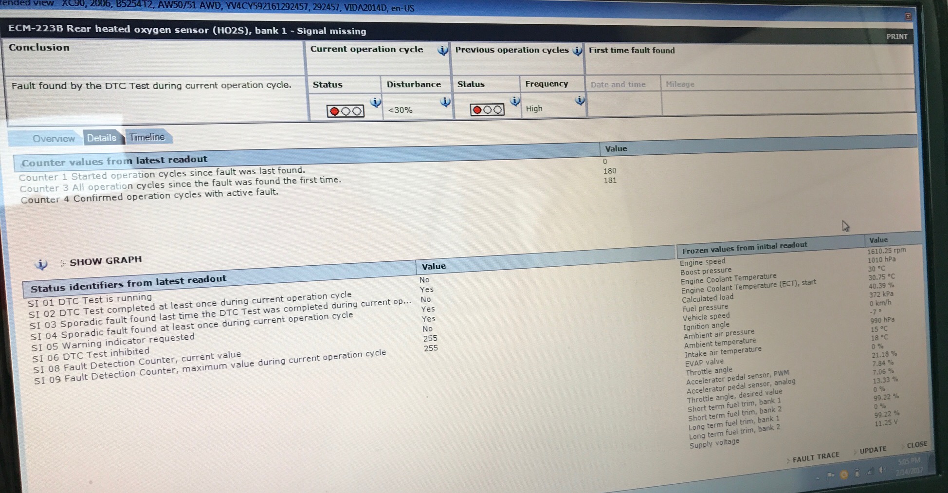

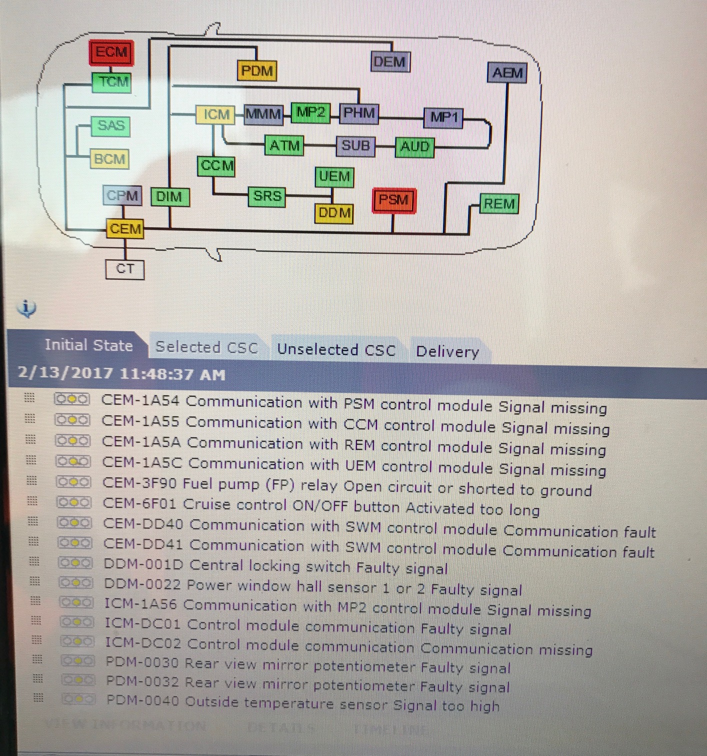

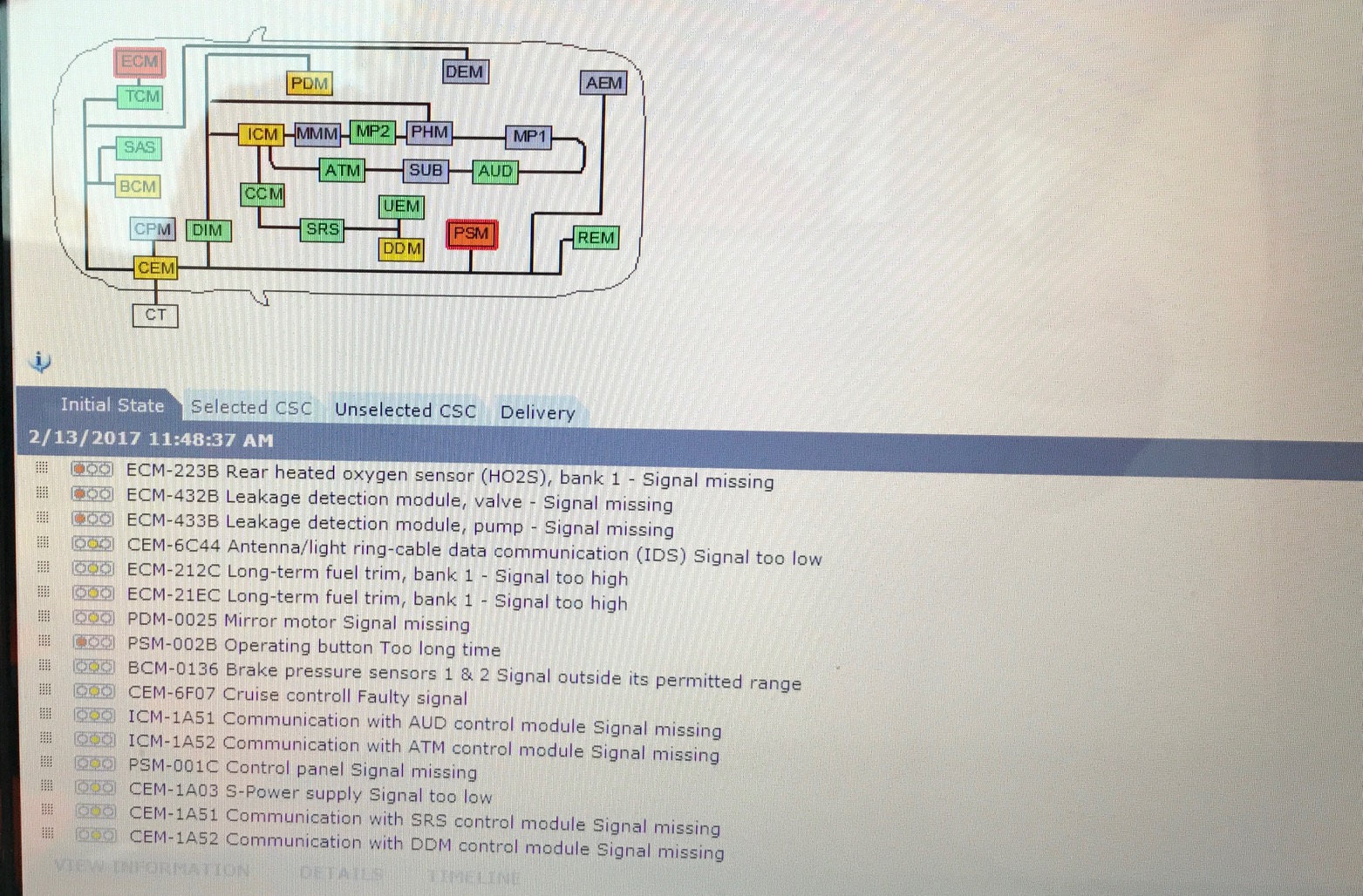

I am attaching some images of my scan on my vehicle. Its an 06 Volvo XC90 2.5L T Any advice on steps moving forward would be appreciated. Thanks!

It should walk you through fault tracing for each code. You probably need a leak detection pump but it could have a wiring issue. It also likely needs a rear oxygen sensor.
