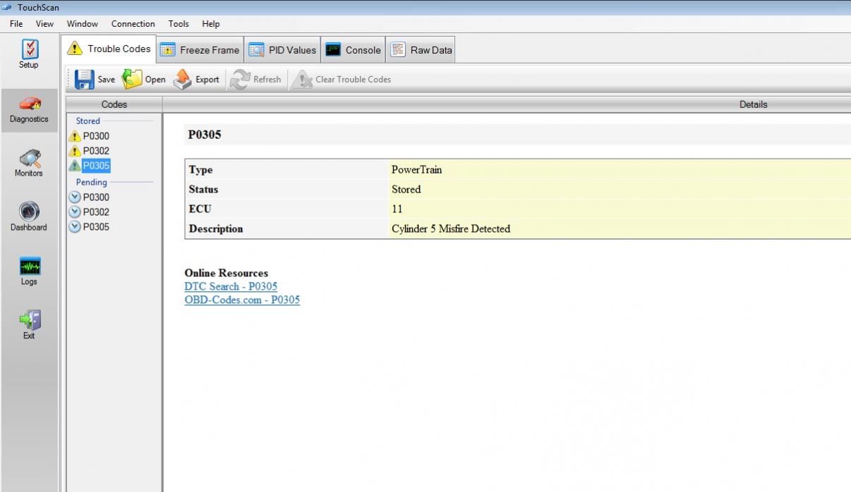

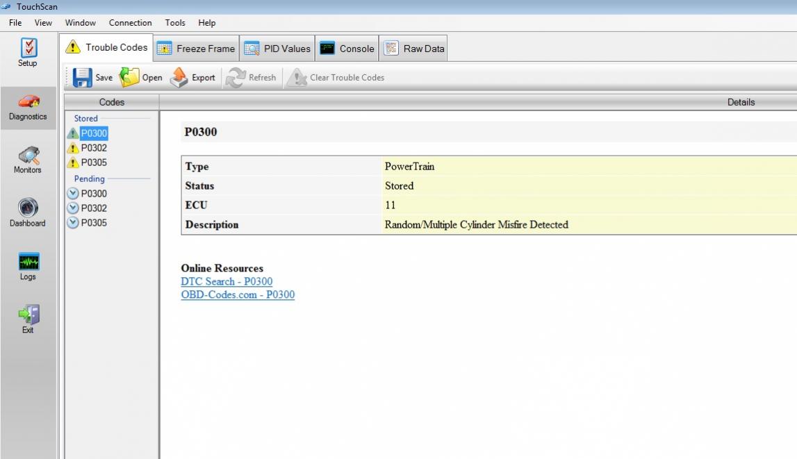

hello everyone i really need some help i recently bought a Volvo XC90 with the 2.5L T5 Engine this is my daily runner for the kids and would really appreciate some help
this is the problem on the OBDII
intermittent missfire P0300 (P0302 & P0305) Cylinders 2 & 5
here is what ive replaced so far
Spark plugs (Official Bosch Volvo torqued to 22 ft/lbs and gaped to specification)
Ive replaced all 5 coils and the fuel rail and injectors have all been replaced recently
also just replaced the oil with castrol synthetic 5W 30W
but the problem is still present
ive read it could be the crank positioning sensor but i would like some more opinions
thanks for your time

Need to do a cylinder leakage test next

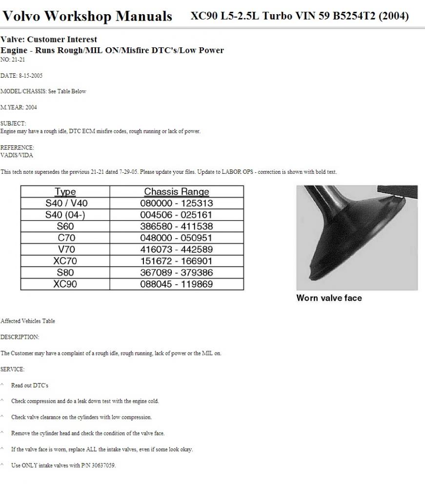

ive just saw this on the internet could be the Valves ???
Attached Thumbnails Volvo XC90 T5 intermittent missfireP0300 (P0302 & P0305) please help-volvo-intake-valve-replacement.jpg
Old Feb 9, 2014 | 09:35 AM
ES6T's Avatar
Posts: 5,517
Likes: 73
Yes, valves are the most likely problem. The cylinder leakage test will determine where the leakage is. You can also pull the injectors and spray some carb cleaner on the valves when doing the cylinder leakage test to see how much is leaking past the intake valves.
