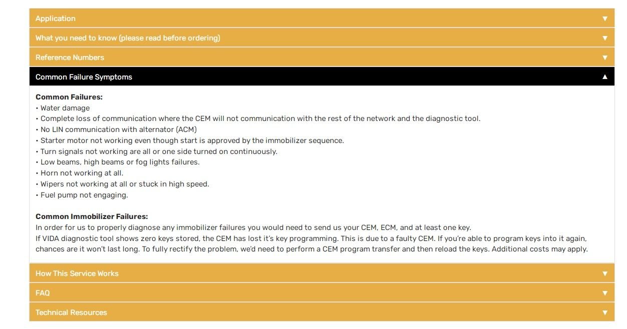

Here's what xemodex thinks are common failures
