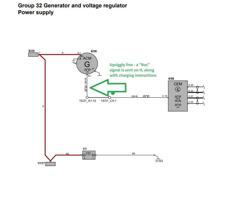

Battery light - A basic alternator circuit has a fat red charging wire to the battery, a ground connection (usually the case) and the small D+61 wire that would go to the warning light on the dash. When the voltage in the battery was higher than the voltage coming out of the alternator - the light would come on. That's not what you have.
The d+61 wire on your alternator (labeled B:1 on the diagram) is connected to the CEM and using a LIN -bus system controls the charging rate. Not sure what alternator you have installed - but I'd bet the regulator is not capable of communicating on the LIN bus. (local interconnect network)

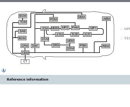

As for my scan tool. very basic. able to read whats there and clear codes. Not sure how to access a specific module.

Here's a diagram of all the modules that could be in your car. Most of them are. (you probably don't have a PHM (phone) or SUB (subwoofer)
A compatible scan tool can talk to all of those modules. A basic scan tool is usually just for emission related codes and can usually only communicate with the ECM and TCM (engine and trans control units)
