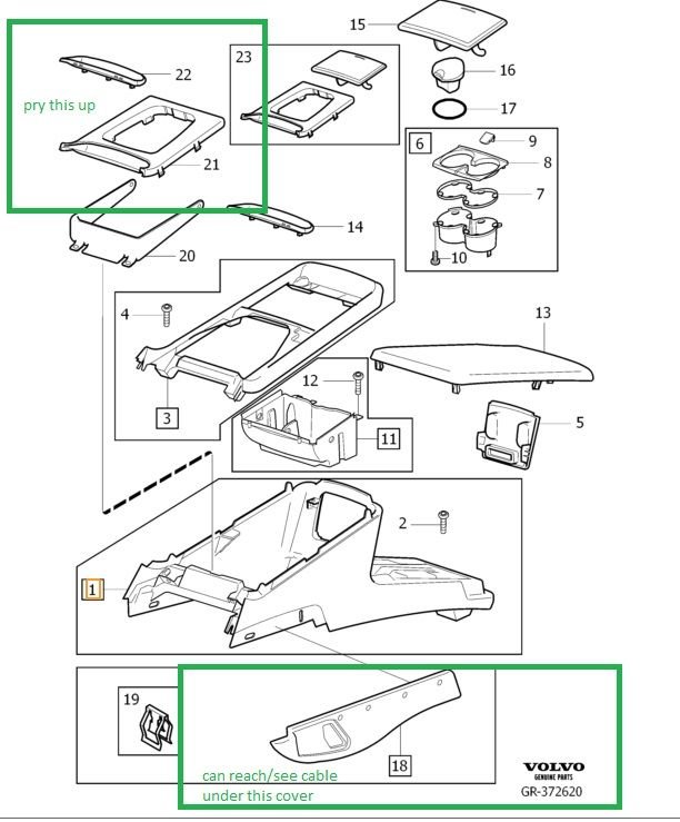

There is a small black cable that goes from the steering column lock to the shifter. If that cable sticks you can't move the shifter or going the other way can't get the key out. Cable is visible on the left side of the shifter after you pull the surround around the shifter in the console up (then try the spray penetrant/lubricant of your choice to hopefully help)
Thanks for the info. I will try it out. Don
