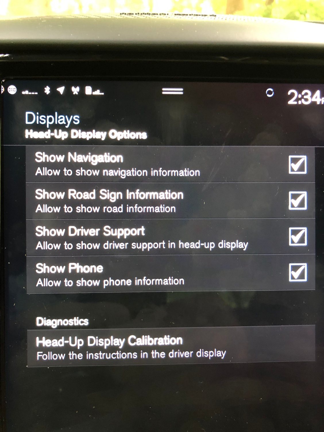

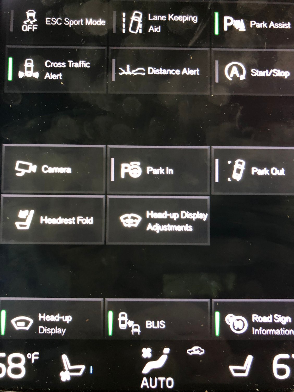

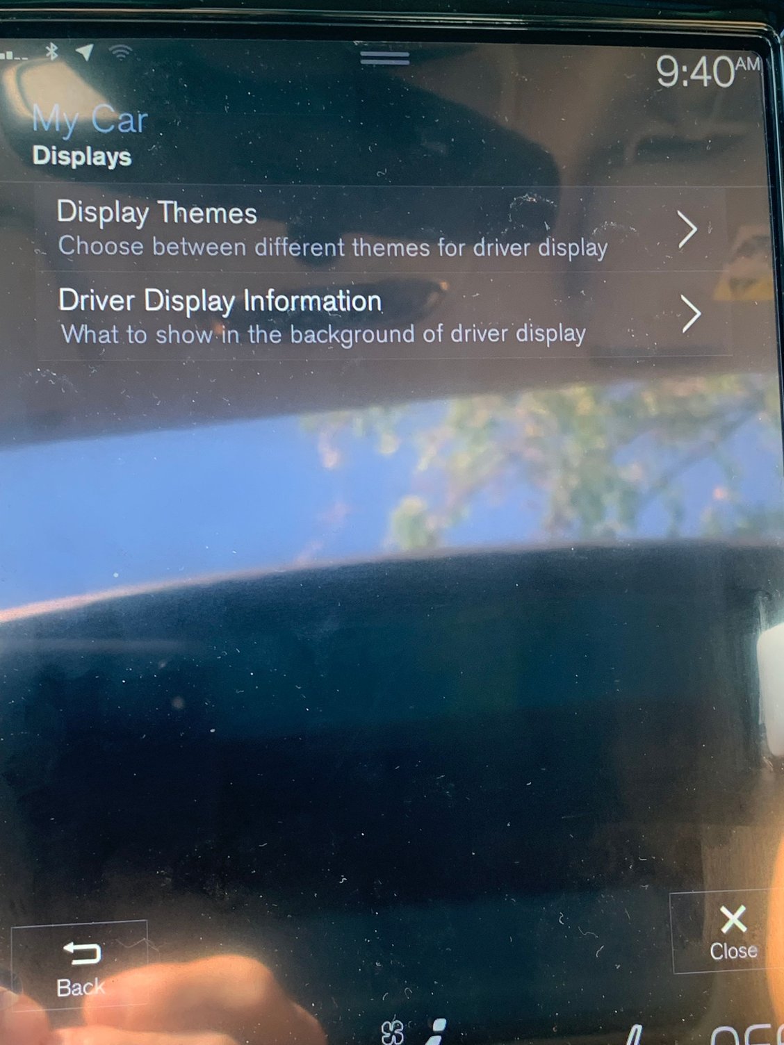

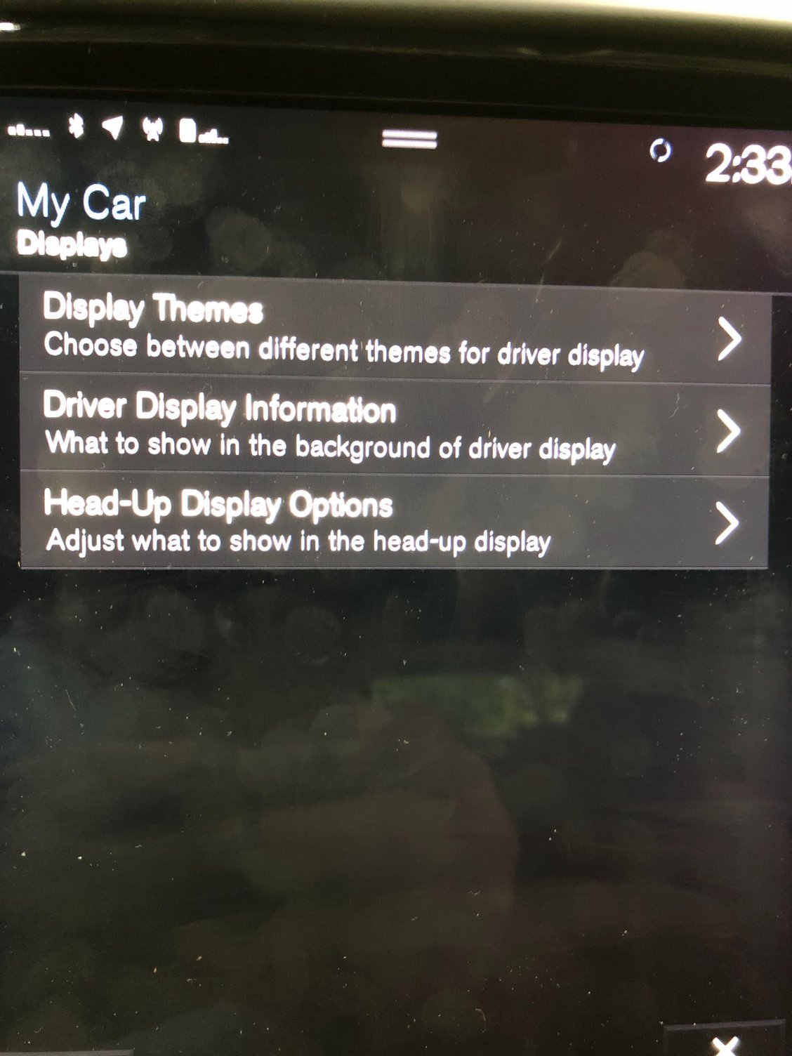

Old Jul 14, 2022 | 01:40 PM
Photos from my 2020 xc60 with heads up - projector in top of dash - and screen shots

Mine is a 2016
Old Jul 14, 2022 | 02:25 PM
You don't have head up. That's the glowing/flashing red light that comes on when the car thinks you are too close and about to crash. (if turned on) I doubt if it could be easily or economically retrofitted. For one thing the windshield if different, and a replacement on my 2015 with the auto cruise control was over $1500 just for the windshield a few years ago.

Thank you, yes I figured that out when I saw your photos. much appreciate it. I will have inquire on what that would cost and if it can be installed on mine.
