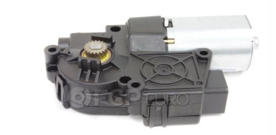

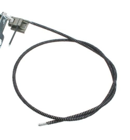

The grinding noise you are hearing is the gear on the sunroof motor (typical motor pictured below) grinding away at the "teeth" on the typical cable pictured below. When you hear that noise usually the only fix is new cables, and repair what jammed or caused the cables to get damaged, The gear on the motor is a harder material and is usually OK. There are two cables - a left and a right and they have to be perfectly aligned/timed. Usually there is a problem on one side and it strips or "jumps time" on only one side, damaging one cable more than the other. Then the sunroof gets pulled and pushed at an angle. Sometimes if you can realign/re-time the cables you can get the sunroof closed. Sometimes the motor has simply worked loose and after you align the cables the sunroof works ok again. You can spend a few hours replacing cables.
