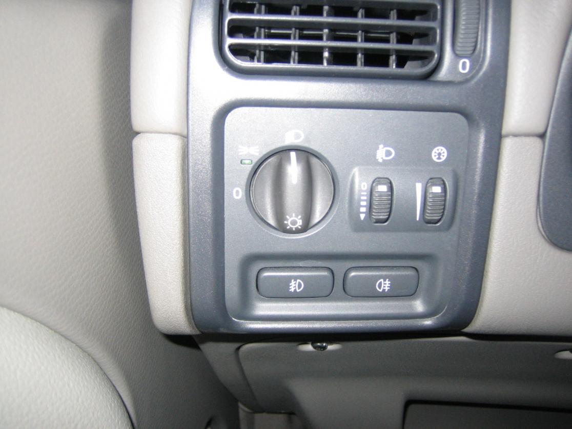

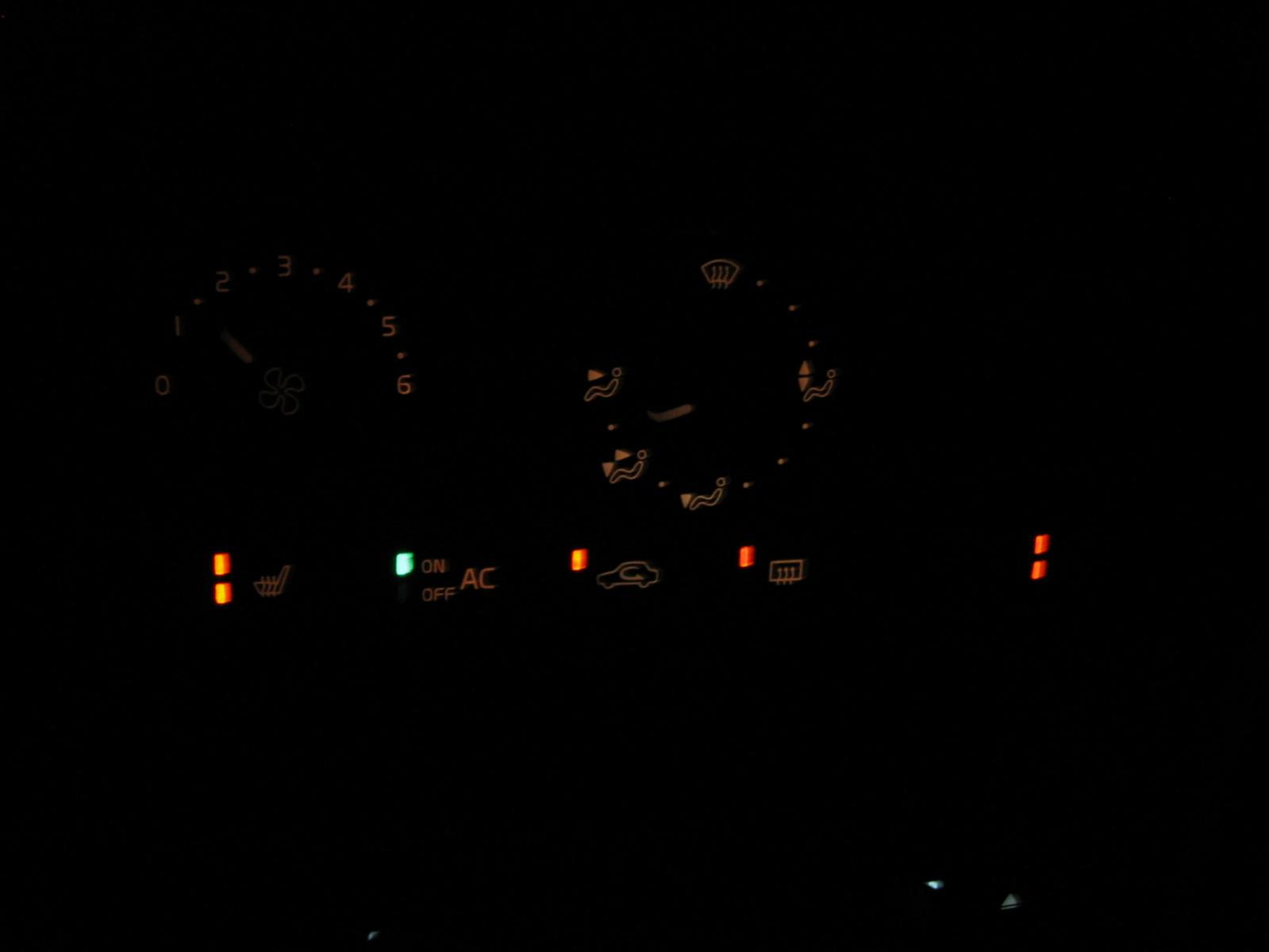

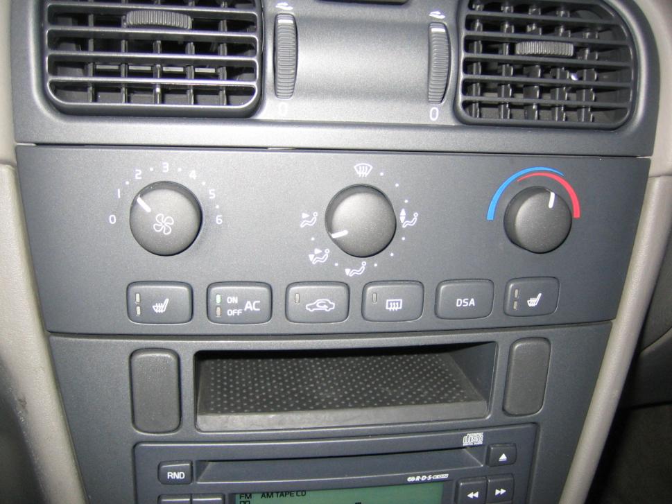

Thought I'd wipe the dust off this thread instead of wasting forum-space. I think I have a busted bulb in the climate-control, but I have no idea of how to get to it or change it. The pictures below should help.
Thanks.
P.S. Also included a picture of the exterior-light control. Not sure if it's supposed to be lit up or not, suggestions are more than welcome.

I have replaced all of the bulbs in the dash on my '03 S40 and I'm here to tell you it is very easy. The three bulbs in the climate control can be bought at the dealer and yes they are expensive. You can take the cover off of the climate control by pulling from the edges. You will then need to unscrew the screws that hold the climate control into the dash. I believe you will have to take the radio out and the radio trim piece off and probably the center console. This is a lot easier then it sounds. On the headlight switch I believe there are two bulbs. You have to remove screws at the bottom and then wiggle the whole unit out of the dash. The bulbs connect at the back.

I have all three bulbs out on the heater panal and have now disassembled to get at the bulbs. The front panel does indeed need prising off with a flat blade screwdriver.

Have you removed the cilimate-control unit from the holder? (The white boxy-looking thing with the bulbs sticking out of it).
If so then you need to open it up and use a screw-driver to remove the bulbs from the circuit board directly. Each of them has a slot in which to position the screw-driver and then just turn them half an hour or so and they should become loose.
