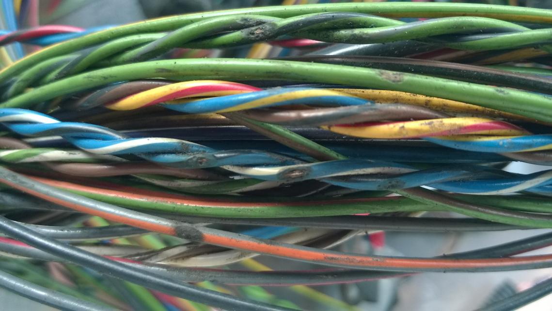

Thank you for your response. I should have updated this post with the resolution but since there had been no responses I didn't know anyone was taking an interest in it. Long story, but after putting in a new ECU it fired right up - and ran 2 miles until it did the exact same thing! Ended up going through about 4 ECUs as each time I thought I'd fixed the problem I hadn't. I finally pulled the whole engine compartment wiring harness and found areas where the insulation had worn completely through (see picture) due to long-term abrasion. There were obvious signs of shorting so I wrapped each wire where I found the missing insulation and the car has gone around 300 miles with no problems.

Had I seen this back when you first posted it, after reading the symptoms and diagnosis you mentioned, the wiring harness is exactly what I would have suggested to you to check. I am surprised that no one posted a response to this as it is a known but not often talked about issue that is subject to failure with these models and other Volvo cars. I have had to do some kind of wire harness repairs on every Volvo I have owned during the past 30 years, including the 98 V70 GLT that I now drive daily.

They are part of the wiring harness that runs from the ECM and TCM box on the passenger side of the engine compartment across the compartment along the crossmember with parts branching off along the way for various sensors and controls. It's inside a covered plastic tray to protect it but the tray has a tendency to fill with grit and grime over time. The particular section that had the bare wires was were the tray makes a bend as it connects with the crossmember. The arrow in the picture points to part of the tray.
