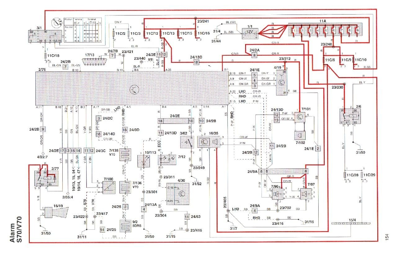

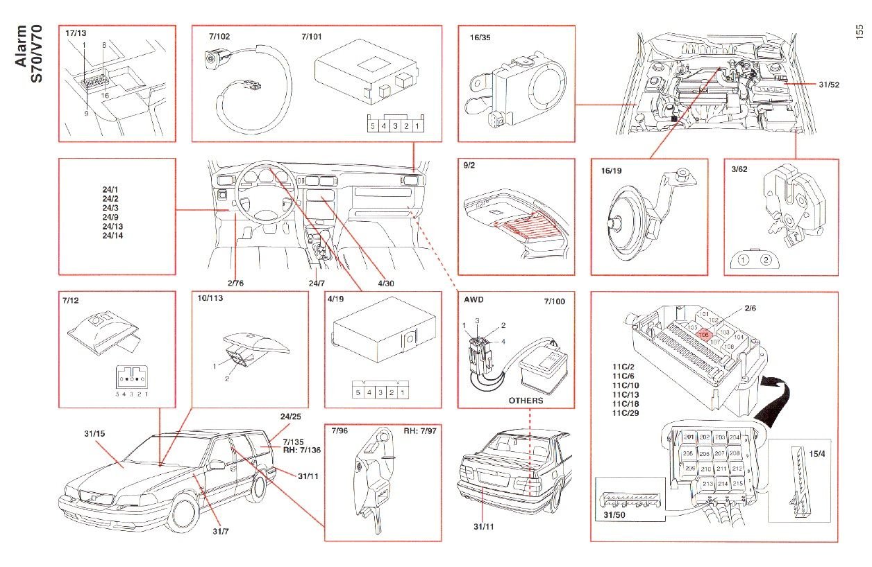

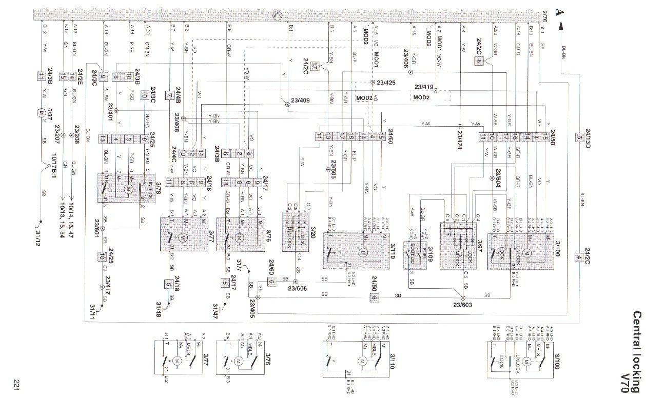

I think I would first test the alarm to verify the alarm siren and or horn does not work. I'm familiar with the alarm horn 16/19 mounted on the firewall, they fall apart. Don't know about the alarm siren that has a horn picture in it #16/35. Roll window down, lock car, wait, reach in and open door - lights should flash and alarm should sound. So then let's guess that something is setting the alarm off and the siren/horn does not work. In each door and tailgate built into the latch assemblies is a microswitch that tells the lock/alarm module 2/76 that door is closed. One of those could be the problem - they will need to be eliminated and tested one at a time. On the Central locking diagram those are built into 3/100, 3/110, 3/76, 3/77, and 3/78. By the way as of about 10 years ago some of those inner door latch assemblies were no longer available new, and my large Volvo only junkyard does not have any. Other sensors can set off the alarm. On the Alarm page there is a hood switch 3/62, a tilt sensor 7/100, and there could be glass break wires in the cargo windows 7/135, 7/136, as well as a glass breakage microphone and sensor 7/101, 7/102 and 7/96 and 7/97 left and right movement sensors.
So you can see there is a lot to check, one part at a time - and I understand why 3 shops have not solved your problem. There's a brake job or a service on another car that gets done, they get paid and move onto the next car - Ignoring the 25 year old Volvo that was build maybe about the time they were born and might be the only one they have ever worked on.
This is probably only going to get fixed by you - no shop is going to invest the time needed. (unless you give them unlimited funds up front, and there is still no guarantee they will be smart enough to figure it out.)
What would I do? Probably disconnect the hood switch 3/62 on the left side of the core support and see if the problem happens. It's maybe the easiest part to get to and I have seen many disconnected. The next place would probably be the drivers door latch assembly - that's the one that has been used the most and as mentioned earlier is not available. If the door microswitches provide a ground when closed (telling the alarm it's ready to arm) you might be able to bypass the offending switch and permanently ground that wire . The lock/alarm module 2/76 might be modified to negate the alarm function - I'm guessing you might be happy just to be able to lock the car.
