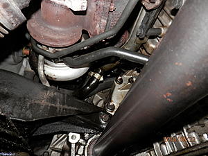

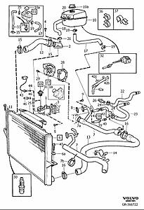

Here is a picture of the rubber hose that split at that hose clamp. The hose goes to one of the 2 nipples on item number 7 of the coolant diagram. I fixed that, then the hose from the thermostat to radiator; item 12 in cooling diagram, blew off after driving 2 miles down the road.
I have never had a volvo before, so I am not sure how everything is connected. I think the engine sounds okay, but I am not sure what sounds I am expecting. I would think I could hear the turbo more, maybe...

The hoses on item #7 are heater hoses, at least one.
Hose #12 is the upper radiator coolant hose. If you're blowing them off you either have excessive pressure or the clamps are not tight. From what you are describing, it appears to be a head gasket leak.
