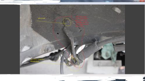

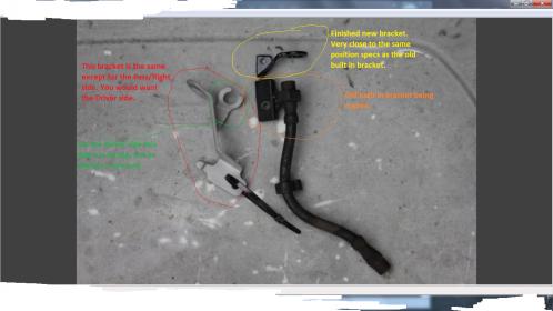

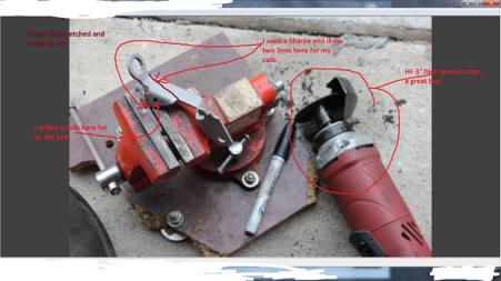

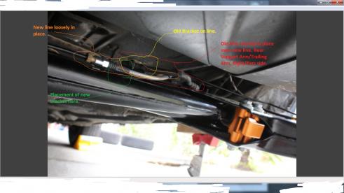

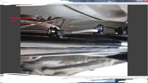

I bought SS braided brake lines for my 1998 Volvo V70 Base Model from FCP, when I got to the rear, I saw the old bracket was built onto the rubber line, and it was not removable. This is how I created a Volvo factory install with the aftermarket SS line, and modifying a factory front Driver Side brake line bracket, from a 1998 Volvo V70 XC AWD.
