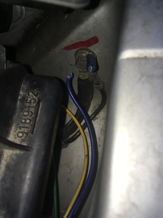

Found 3 wires he chewed so far. One the blue wire at the ground next to the airbox, and the other two coming from the ignition coil. The two from the coil look like the stubs he left me might be too small to solder....Maybe I can do it and use a shrink tube what do you guys think?
There are probably more chewed wires. Squirrels, and rodents in general can cause a lot of damage to the electrical system. I had to replace a complete harness on an Infinity due to squirrels chewing through it.
It may be a job for a shop.
I'm still optimistic because all the chewed wires I've found are close to the nest area so I'm hoping even though he helped himself to the entirety of the engine bay he only chewed near where he settled down for the night. I'm not/don't have the money to pay a shop hours and hours of time to track this down I'll do it bit by bit if I have to.
