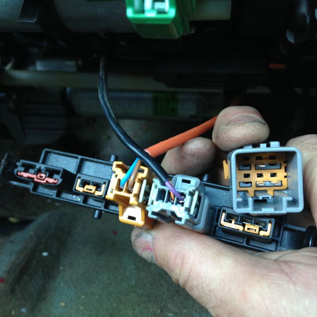

I recently moved to FWD era ( have owned many redblocks) got an'02 V70 with a trashed interior- manual seats and pulled power seats from a yard 2001 XC70 and it appears that the difference is that they moved to a single ganged connector on '02 from the individual harness connections. Most of the sub-connectors mate up except one. Also wiring harness colors are not consistent, haven't been able to find wiring schematics for these 2 years. Also I swapped seat with battery connected and have SRS warning light- will buying one of the DICE/VIDA tools allow me to reset this ?(Amazon.com: volvo dice vida)
Attaching a pic of the connector that does.t match up- will splicing these wires make the seat usable (this is driver's LHD)?
