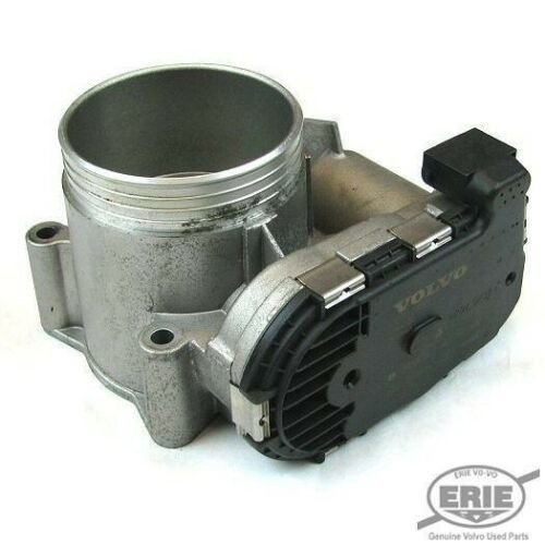

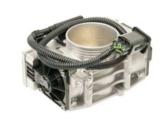

Volvo used 2 different brands of throttle bodies. The non-turbo 5 cyl engine used the Magnetti Maerelli (sp) throttle unit from 99-2002. Turbo cars used that throttle through 2001, c70 used it a little longer.
That means you will get varied info about your throttle housing. The later Bosch throttle is very reliable and if your car is indeed a 2003 that should have been the unit installed. The early throttles were known failures and even if clean there are problems with them when they get worn internally.
Which throttle do you have? Bosch or Magnetti? (sp)
