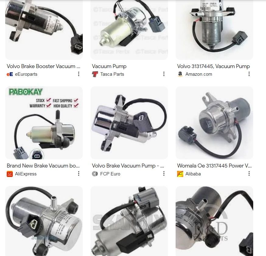

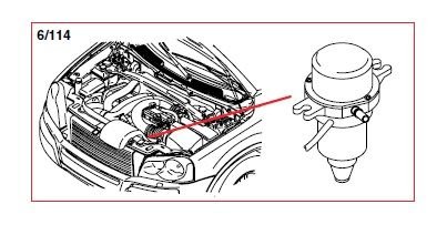

Your car has a vacuum pump for the power brake system. There is very little manifold vacuum when first started and that pump is there to solve that. Commonly the plastic vacuum switch that controls the pump breaks, which causes the pump to run until it seizes up, and sometimes blows the fuse. The top of pump is visible under the hood in the lf corner of the car, switch is near that also.
