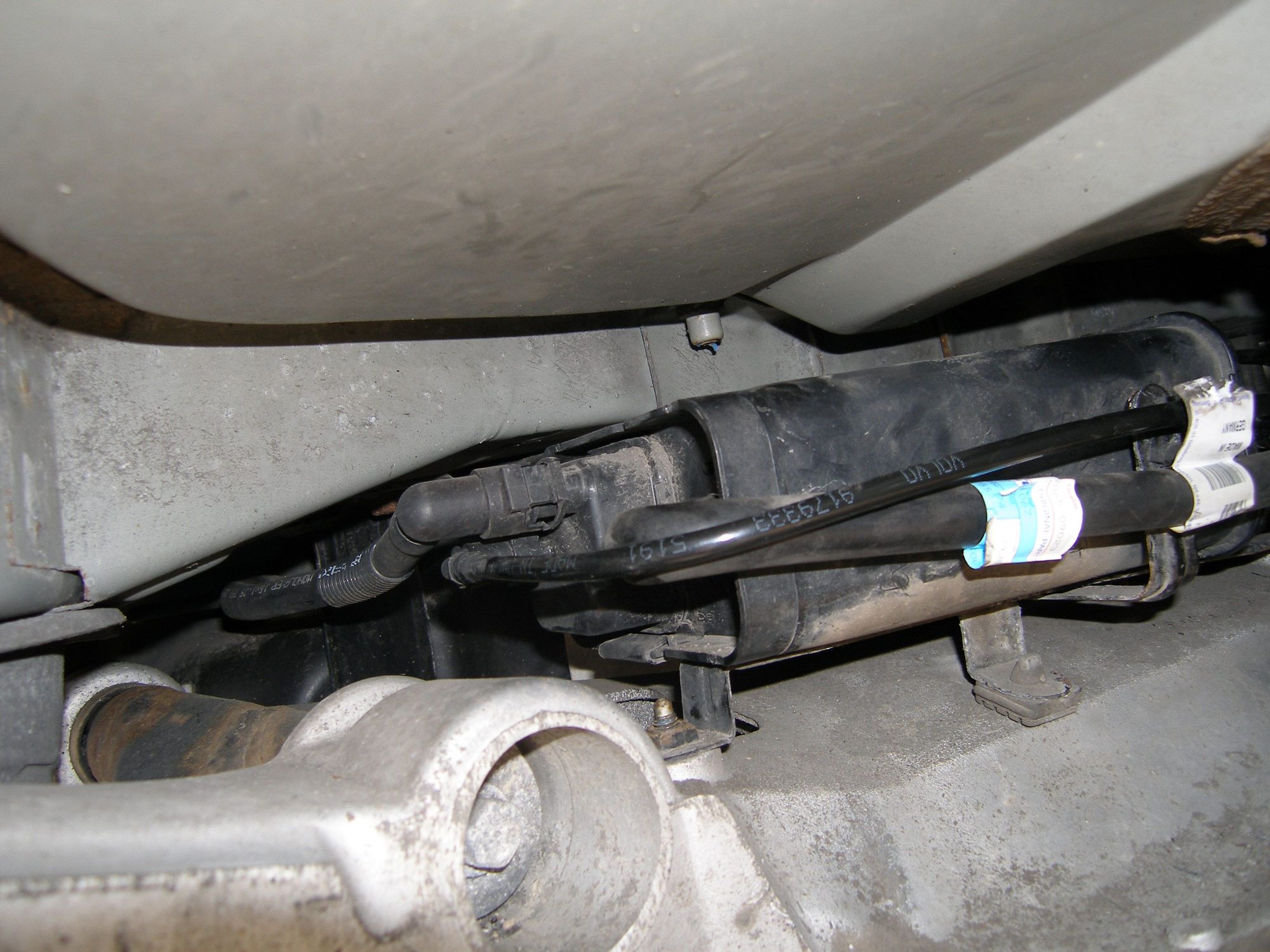

I was mistaken. The location difference depends on whether the car is FWD or AWD. AWD's have a "saddle tank".
I assume that refers to an indentation for the driveshaft.
Sorry for the confusion.
I have FWD. My J hose was between the rear wheels atop the structure which holds the rear suspension.
The "in-place" photo is immediately ahead of the spare tire well.
Removal of the LR fender liner (drilling out plastic rivets - no big deal) was necessary to access it.
The J hose was a $21 part and was made of a soft, pliable plastic. Others mentioned that any 1/2" fuel line hose will work. It does see gasoline fumes.
I've heard the canister in AWD vehicles is on the tank somewhere.
Really get under there and follow the lines.
I've heard the same regarding the temp sensors' locations but I don't know which sensor is in which mirror.

Thank you very much, Great pictures and directions.
Mine is a AWD, so there is gonna be some contorting to check it and change it if need be.
