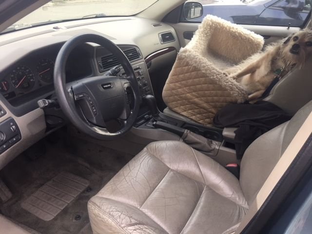

Pretty clean,hoping to help the seats a bit ,no rips though.
Sorry about the bad pic

My dry leather driver seat fell apart. I went for a professionally reupholstered seat in an indistinguishable vinyl for less $.
