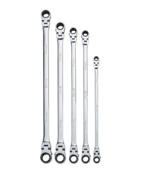

Belt replacement is straight forward - I would recommend making a diagram of the belt routing before belt removal. You will need a very long tool to be able to move and hold the tensioner out of the way to get the belt on. I use a long wrench like pictured below. Anything shorter is very difficult to keep the tensioner pulled back while trying to get the belt in the generous 1 inch gap volvo gives you to work in! You might need a 3rd hand to hold the tensioner while you organize the belt. And I have found a sepentine belt "stick" (pictured below) is very helpful while working in that generous 1 inch gap.
