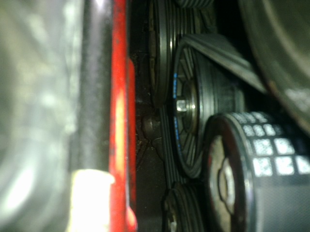

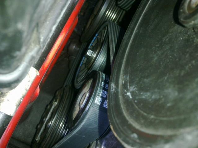

Default 850 pulley
here is a pic of it.it is kind of sitting a lil bit outside the pulley.is there a washer that l have to install before puting back the pulley?

Maybe you dropped some kind of washer or spacer off of it when you pulled the old one off?

yea l took the old one off.l do think l dropped a washer.RSPI do you think the washer goes to the back of the pulley or the front of the screw?

Yeah the spacing looks off...
The washer/spacer should go behind the pulley..

@Matty.do you know how small the washer/spacer looks like? l want to see if l can get one on it as soon as posible before it breaks my new belt.thanks
